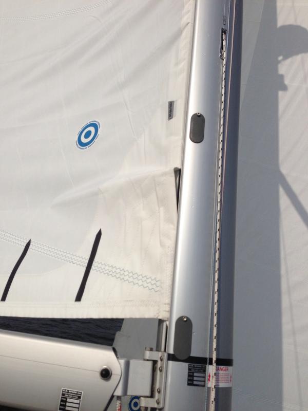

Hello,
Since the delivery of my B41, I have been battling an issue with slack at the main's tack while underway when winds reach 15-20 kt. When going to the mast under those conditions, I can grab the tack and easily slide it up and down and inch or two. The luff above the slack seem to be stretched properly and I verified that the sail is properly set its track all along . Once I de-power the sails and go in irons, the slack goes away but sometimes, the luff gets slightly stuck on the furling slot guide where the slack is shown on the picture. I talked to my rigger several times, he applied a bit more tension to the main halyard which seems to reduce the slack but not eliminate it. He says I need a low stretch halyard. Any other B41 with a similar furler issue? I found weird that Beneteau would have stock rigging on the B41 with that problem. Please take a look at the attached pic and let me know what you think.
Best,
Best,
