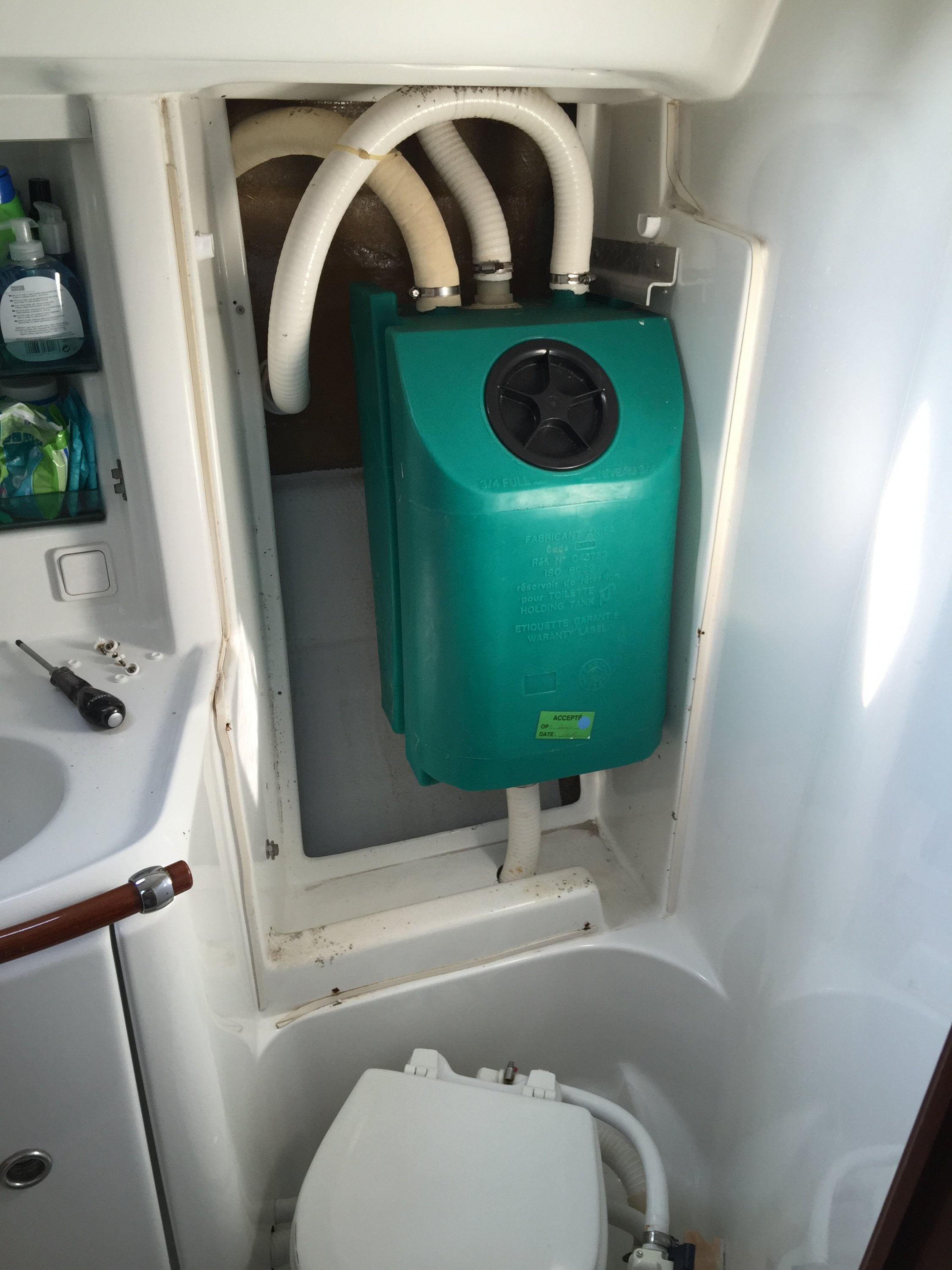

We have 3 hull valves under the sink and then the "Y" valve. No macerator pump. We do have a hand pump to pump waste overboard. The fwd valve is the seawater intake. The aft valve is the discharge from the holding tank thru the hand pump overboard. Not sure what the middle valve is for. We were told that the procedure to pump overboard is as follows:
1-open the aft valve
2-move the "Y" valve to the outboard position (away from you)
3-use the hand pump to pump overboard
This procedure works, but looking at the diagram, it looks like the pump is fed directly from the tank and the "Y" valve is not needed for this procedure.
We are looking for the procedure to flush the holding tank directly with seawater (without pumping water thru the toilet).
Thanks for the help.

I've posted it here many times...and included it in my books (see link in my signature). You have to add water to the tank via the deck pumpout fitting--'cuz that sends the water into the tank at the bottom to stir up any sludge...there are two ways to do it. After pumpout, use a hose (NOT a hose used to fill water tanks!) to put a few gallons of water into the tank...pump that out. Repeat...repeat...till you're pumping out clean water. You'll need a washdown pump to use sea water. Again, put a few gallons into the tank via the deck pumpout fitting, start the macerator pump and let it run while you continue to let the washdown pump add water to the tank till it's thoroughly rinsed out. You must be at sea outside the "3 mile limit" to do this legally.
You don't necessarily need a pump (though you can install one if you need) to empty the holding tank. Gravity can do this once you open the seacock.
Using gravity to empty the tank only works if the entire tank is above the waterline (and again, only legal outside the "3 mile limit"). If any part of it is below waterline, opening the seacock will flood the tank with sea water instead of emptying the tank. Leaving the seacock open while underway can force enough water into the tank to fill it and send a real mess all the back into the toilet.
Absolutely agree with the procedure on how to flash using fresh water via the deck fitting (the "NOT a hose used to fill water tanks" really made me lough!!).
The water line is at approximately the level of the toilet (slightly below in fact) so the entire tank is above the waterline.
