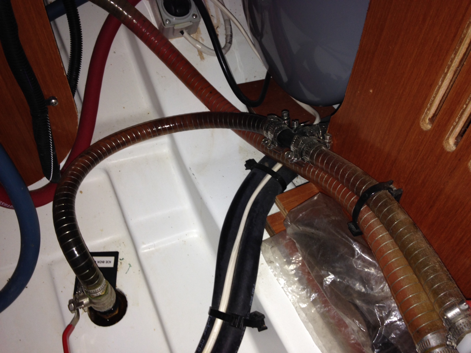

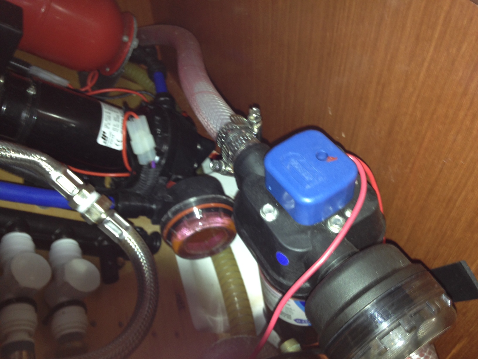

OK, I checked the washdown thruhull today and I had it wrong. The thruhull is indeed to stbd of the water catchbasin for the speed wheel and depth sounder thruhulls, but the water line goes up and over the access door and is then routed on the port side along the forward water tank and then up to the anchor locker.
Feb 21, 2010
349
Beneteau 31 016 St-Lawrence river
I have a 31 which is a descendant of the 331 and 311. I T'd the ice-box drain between the foot-pump and the thru-hull; the ice-box has a plug so that when the wash-down pump pulls it can't suck air from there. I located the pump just forward of the water-heater beside the main water pump and distribution valves. The tubing is then led forward under the Vee-berth and up to the anchor well where I put a waterproof bulkhead type fitting. The electrical switch is beside the windlass switch in the rear cabin.
