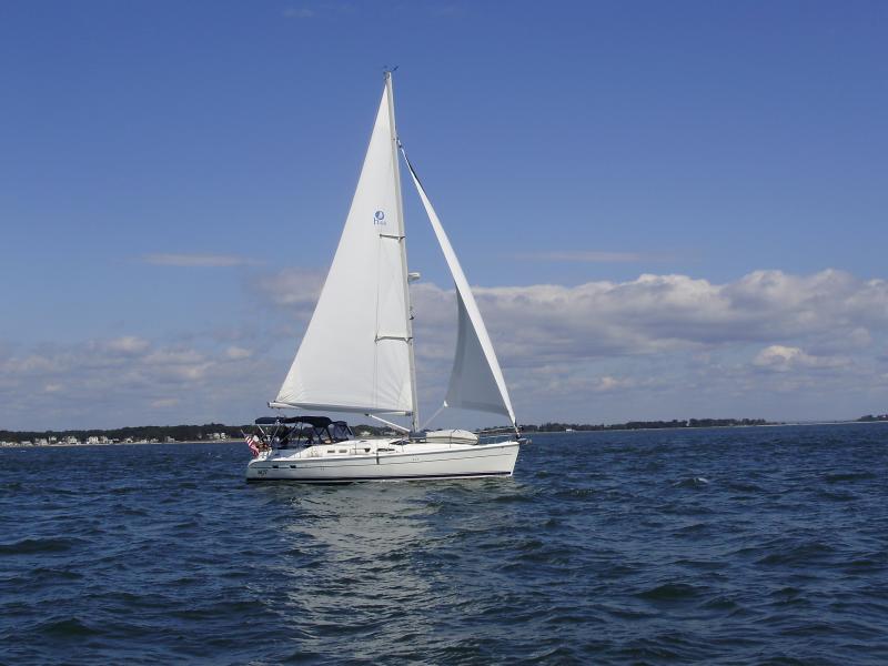

Have never had a problem running downwind. Certainly not an efficient point of sail as we can't get the boom out too far. Here is a picture of MJS4 (H44) with our version of Wing on Wing. Traveler is fully eased and boom is as far out as we can get it without the sail hitting the spreaders.

It's OK if your sail touches the spreaders... just put a dacron spreader-patch on the sail to prevent wear.
A little more vang will also help keep the sail flatter and off the sail. You boom is way high in that picture.
