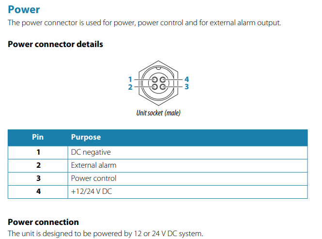

Power TO the Zeus should be provided on the dedicated power port. The Zeus does not get power from the NMEA 2000 bus.
Thanks. I am going to move the power for the Zeus to it’s own connection rather then shared with all the other instruments and see what happens. The only other thing I can think of is overheating, but it does power back on.

Hey,
Absolutely correct ... instructions are abundantly clear about this. The autopilot computer should also have its own power lead. There should be separate power leads for the NMEA 2000 network that has the instruments, a separate lead for the Zeus, and a separate lead for the autopilot. I put each of these 3 leads on a separate breaker switch on the panel. My VHF power lead is on the same breaker with the Zeus because I can independently turn them on and off at the instrument buttons.
