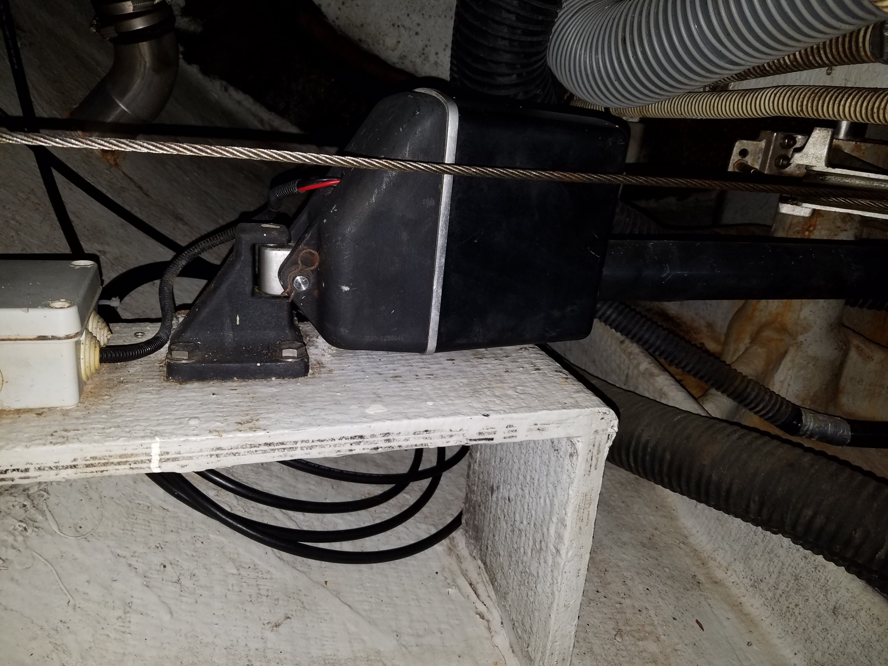

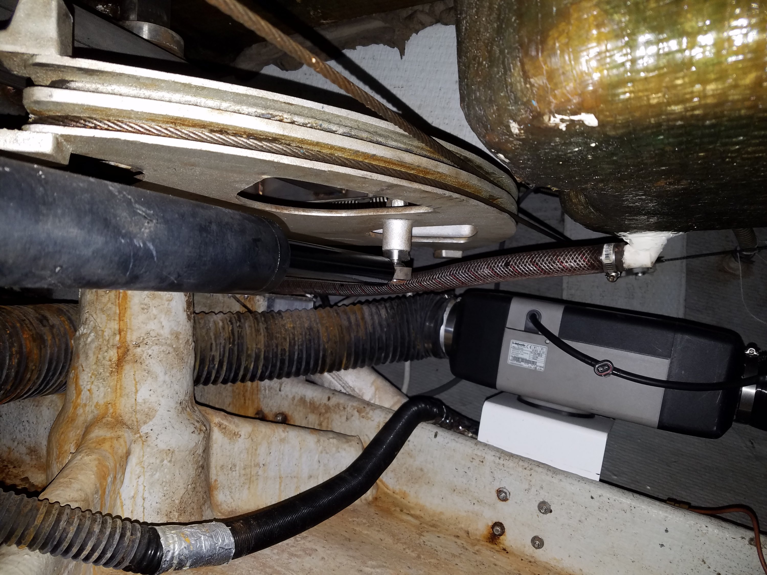

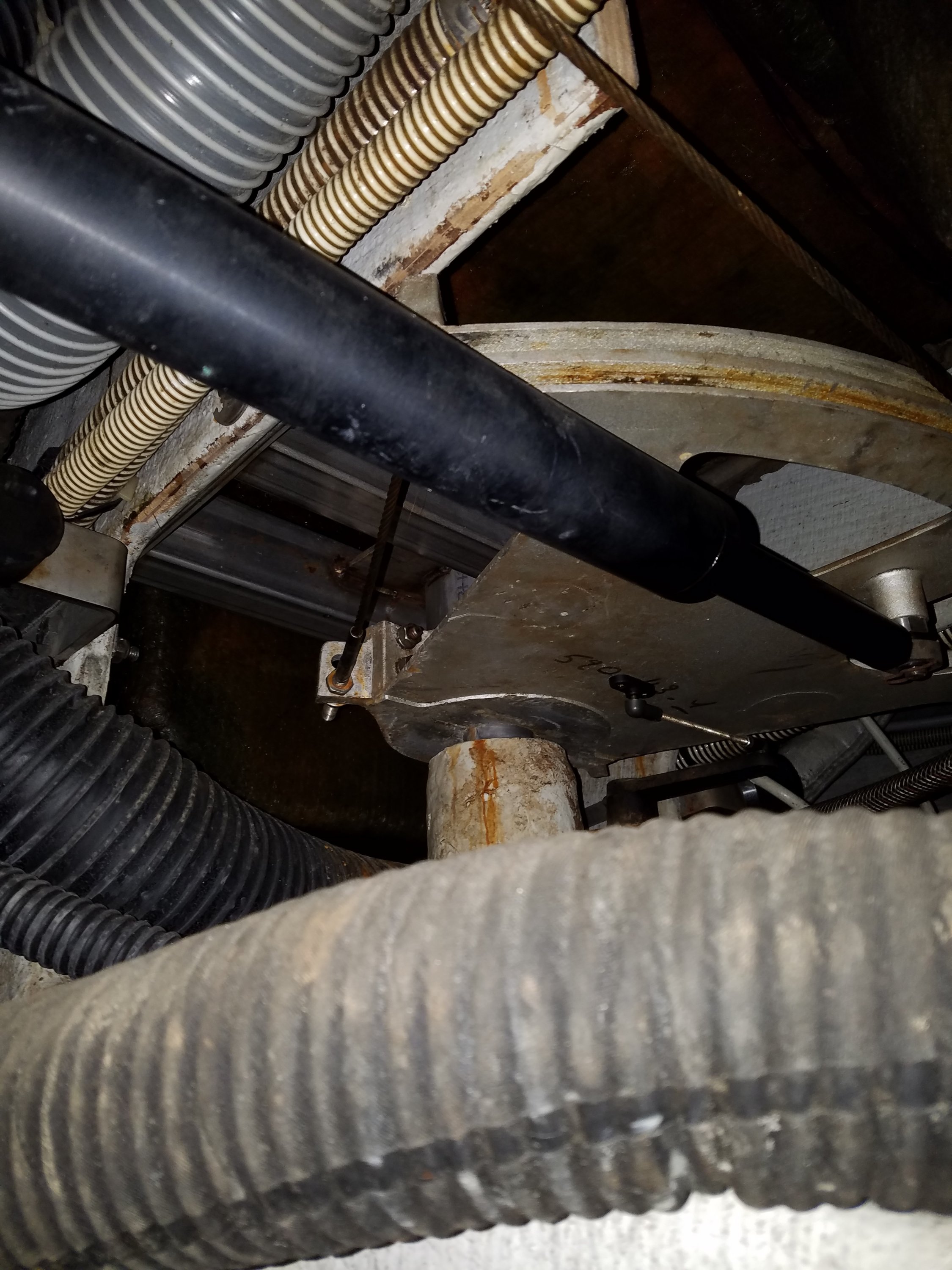

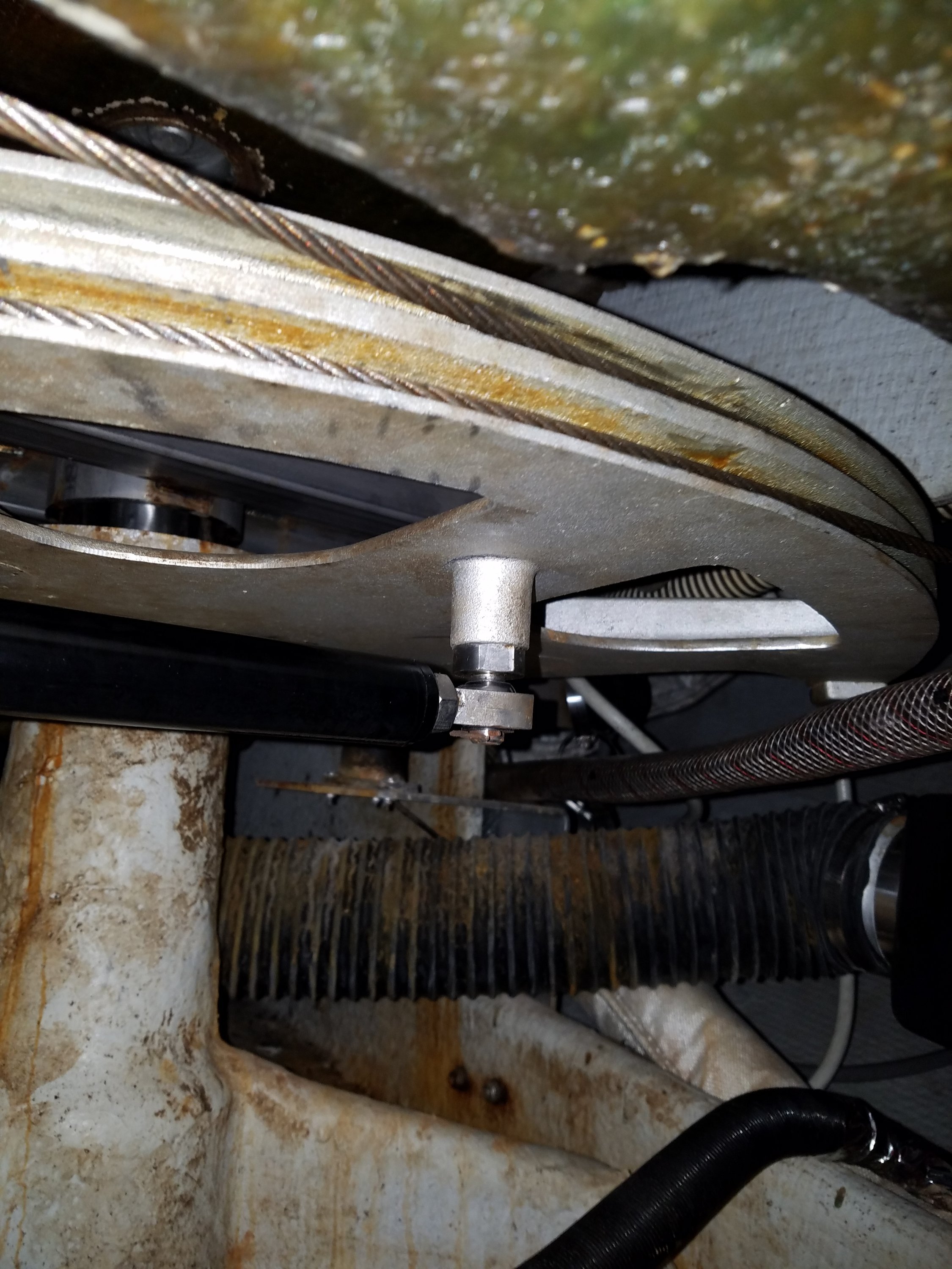

Not BG, and I didn't install it, but since no one else responded, I'll give it a go. Here's pictures of my installation. I believe this is a Jeanneau installation, and its was an autohelm autopilot. I replaced the course computer with Raymarine, but the linear drive, rudder reference and flux compass are original. I have a couple more pictures of the rudder reference if you're interested.
