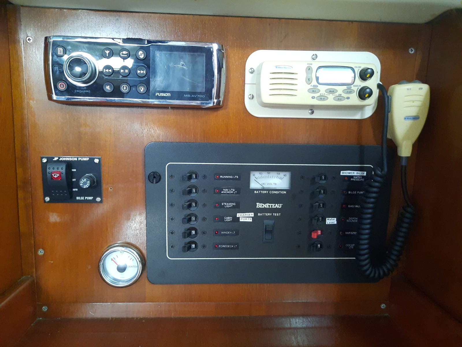

Same here. In my 310, I installed an electronic "float" switch and ran wire to the panel to an ON/OFF/AUTO switch. I don't have any photos of the install but will be on the boat this weekend and will take some and post them up. IIRC, I had to drill a hole in the liner from the bilge to the area below the starboard side settee to snake a wire to the panel.

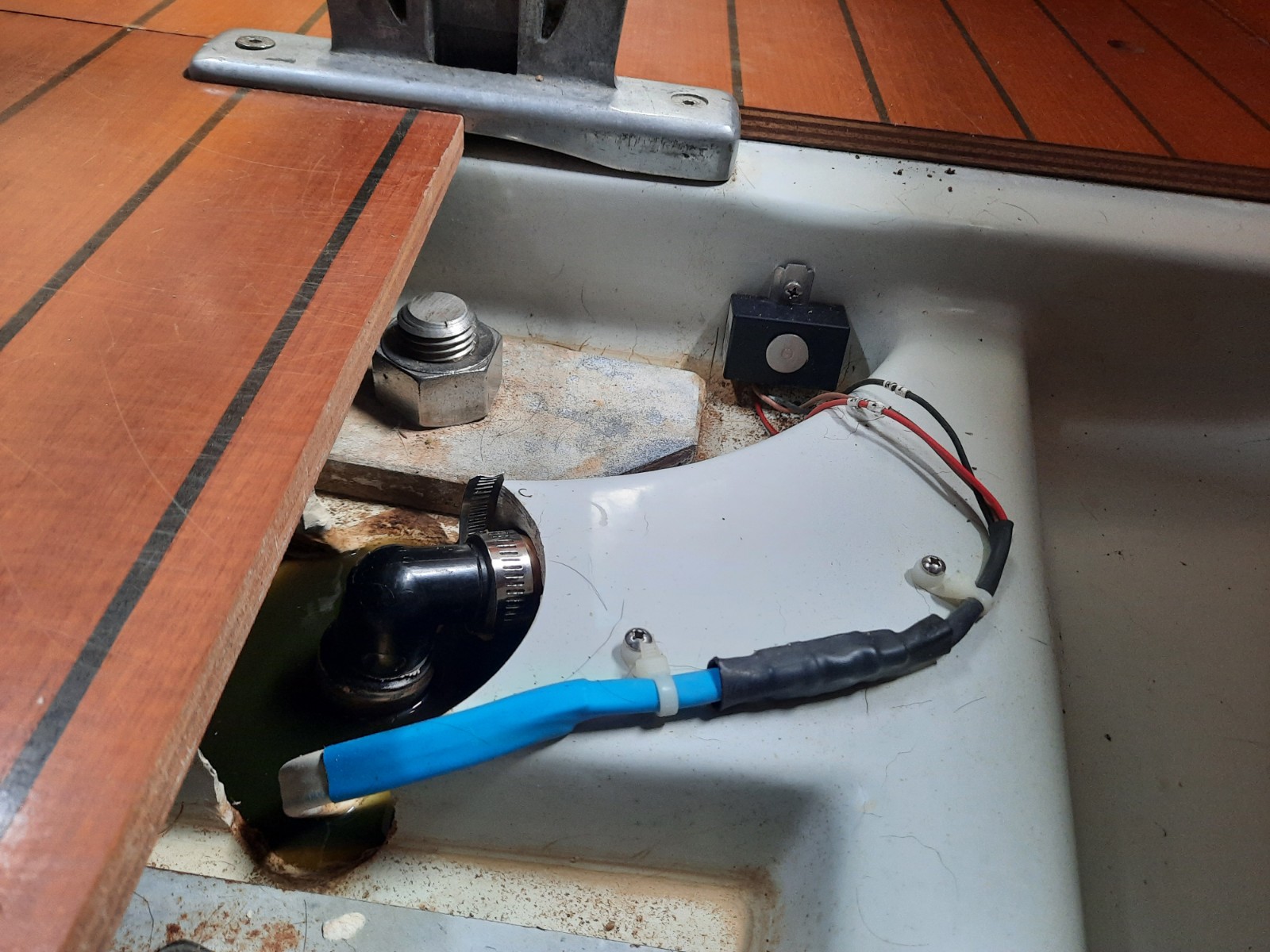

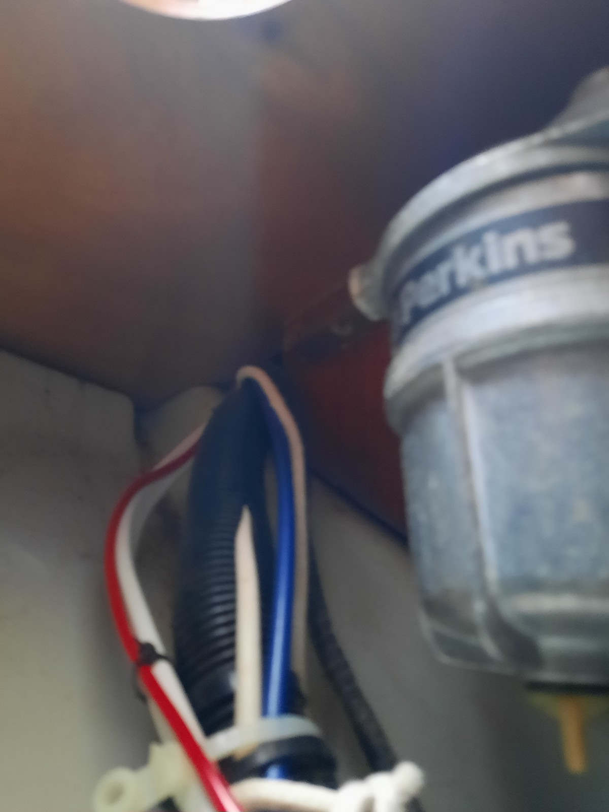

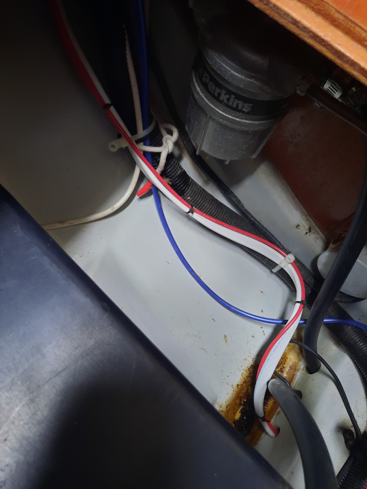

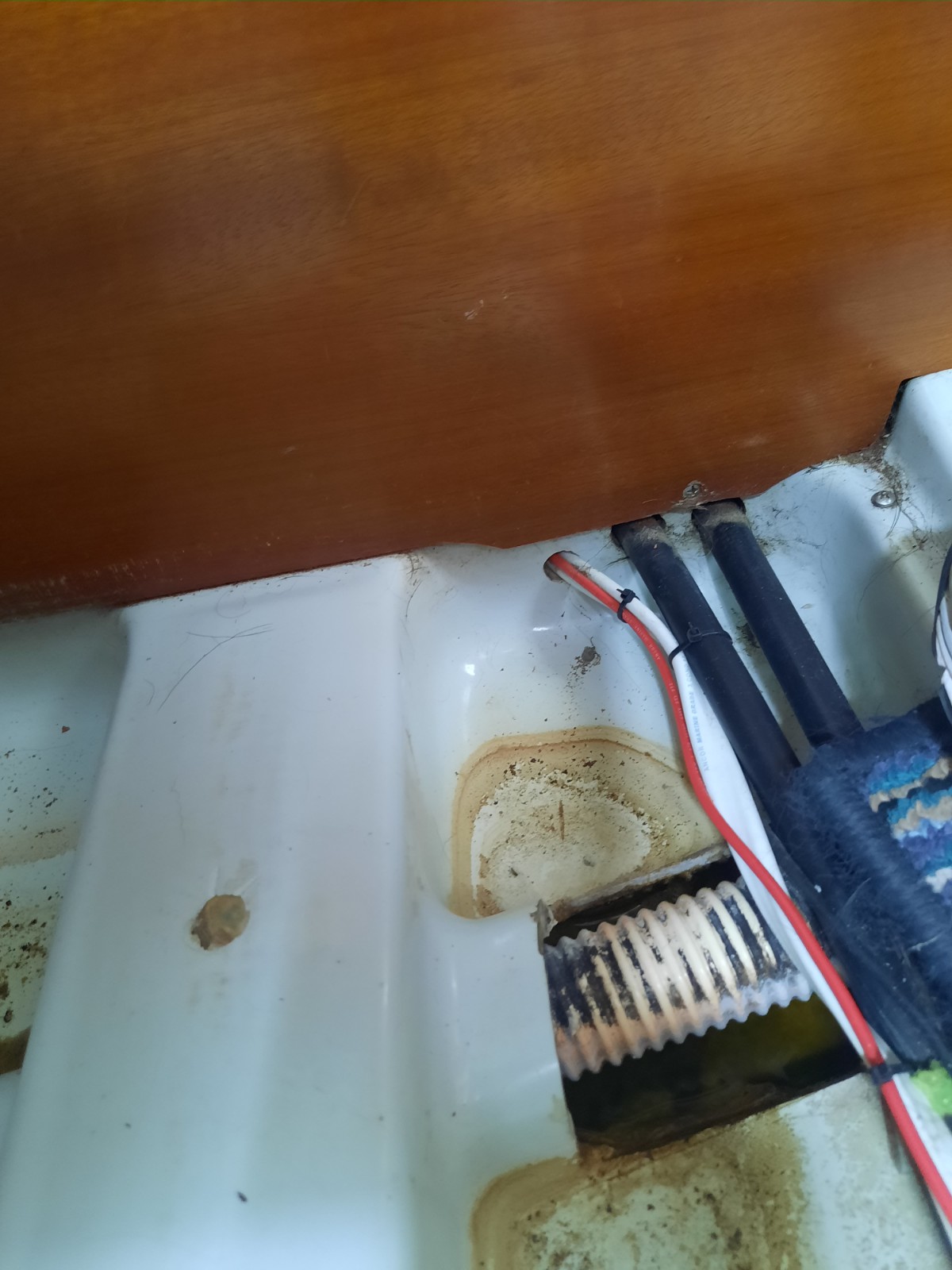

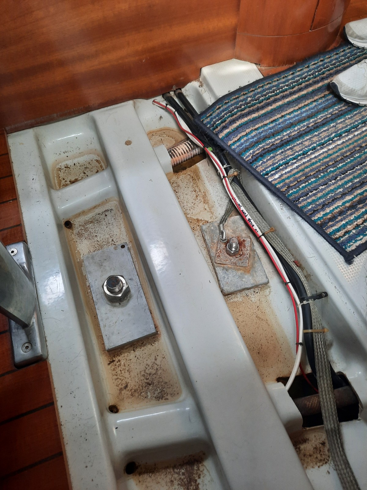

For a simple install, you could use the Johnson electronic float switch as shown in the attachment. Run 2 wires from the switch along the hose, under the seats and back to under the sink in the head. Cut the red wire to the pump and splice the switch wires in.
Leave the bilge switch always on. I've done this on my 352 and has worked for the last 10 years.
