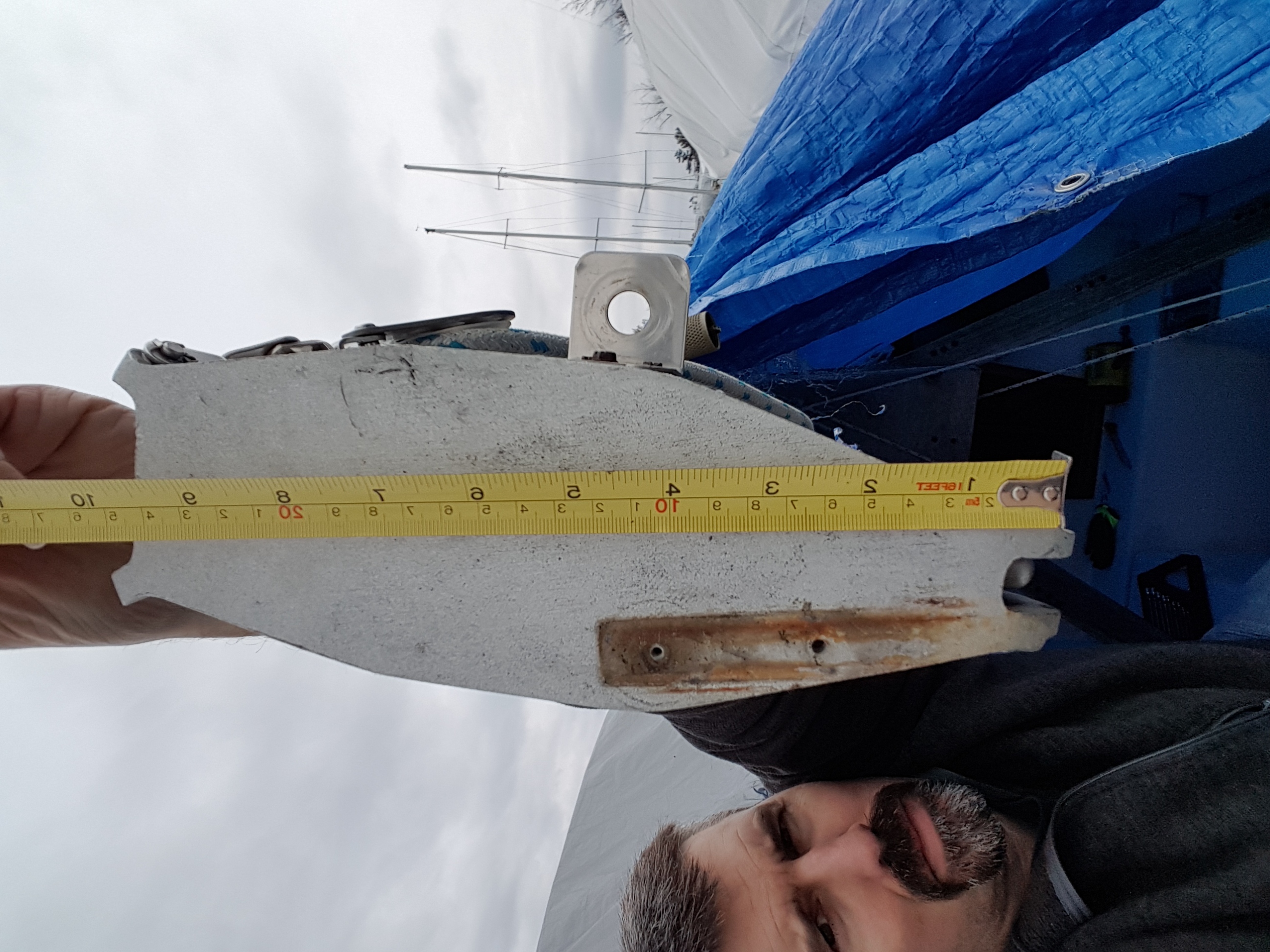

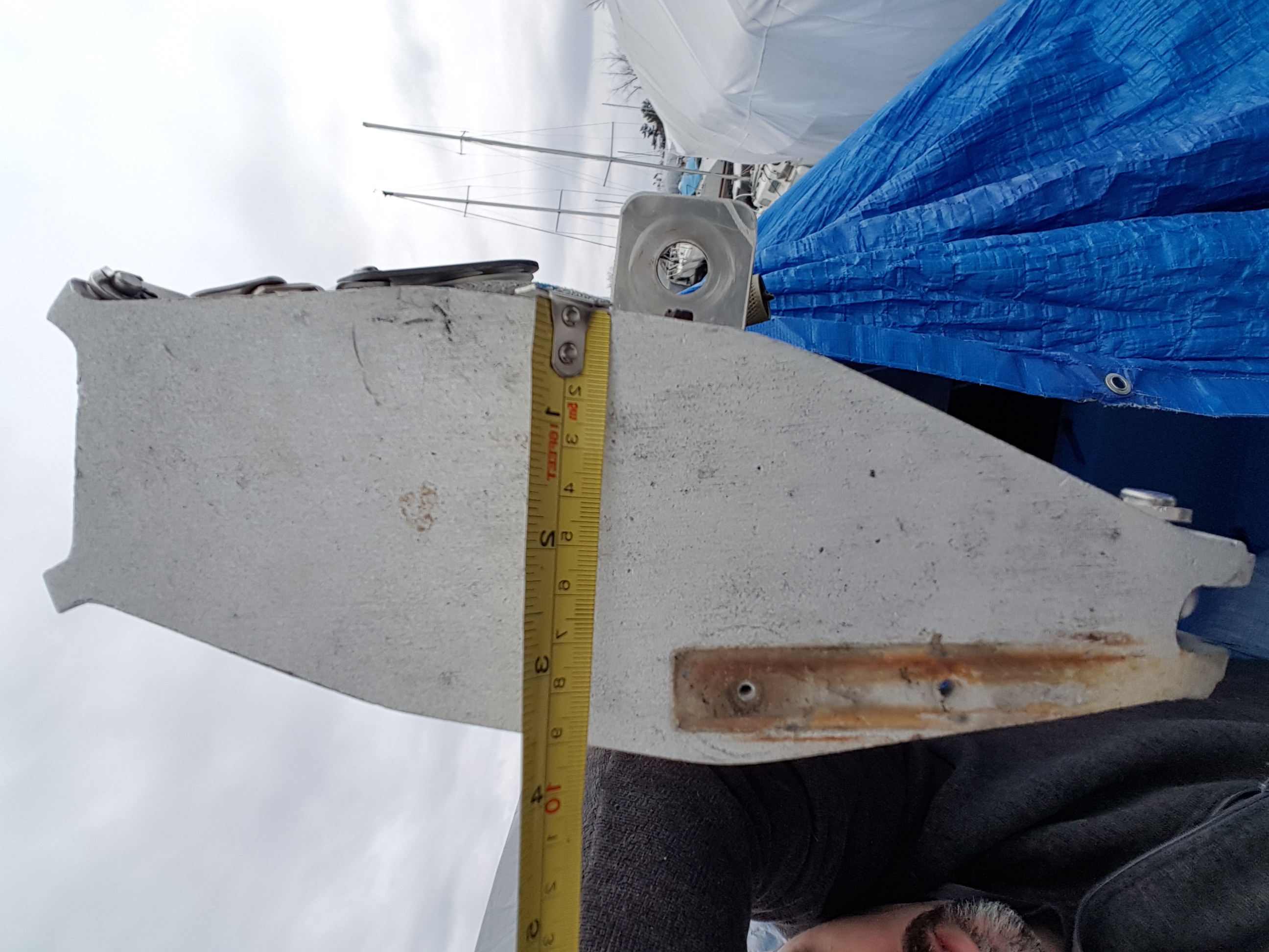

Ever wonder how weird you look when trying to reach into or around things, working on hard to get to parts of your boat? I couldn't see the top of my mast and wanted to take measurements for new fittings so I took a picture. It ain't pretty but it worked.

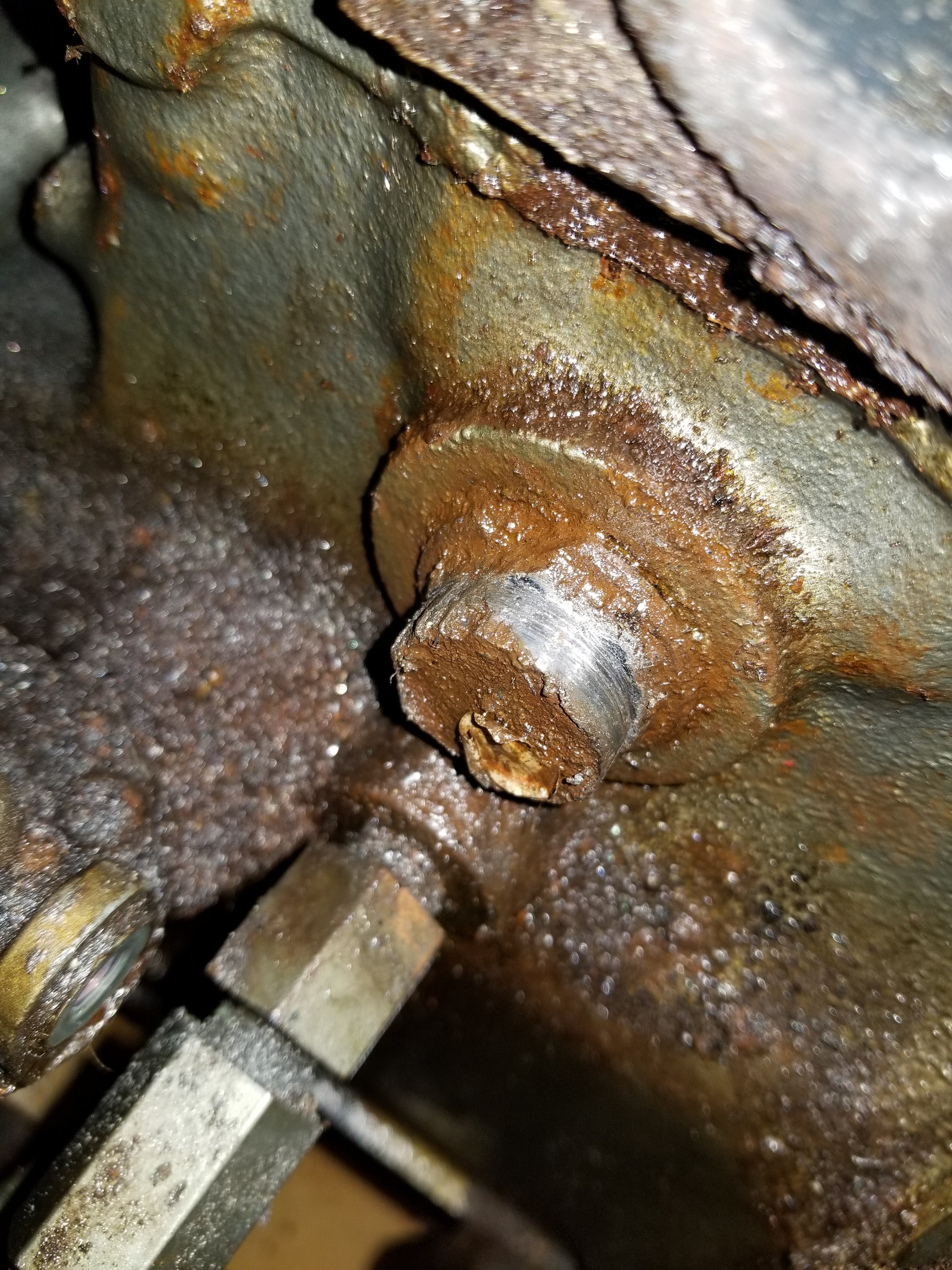

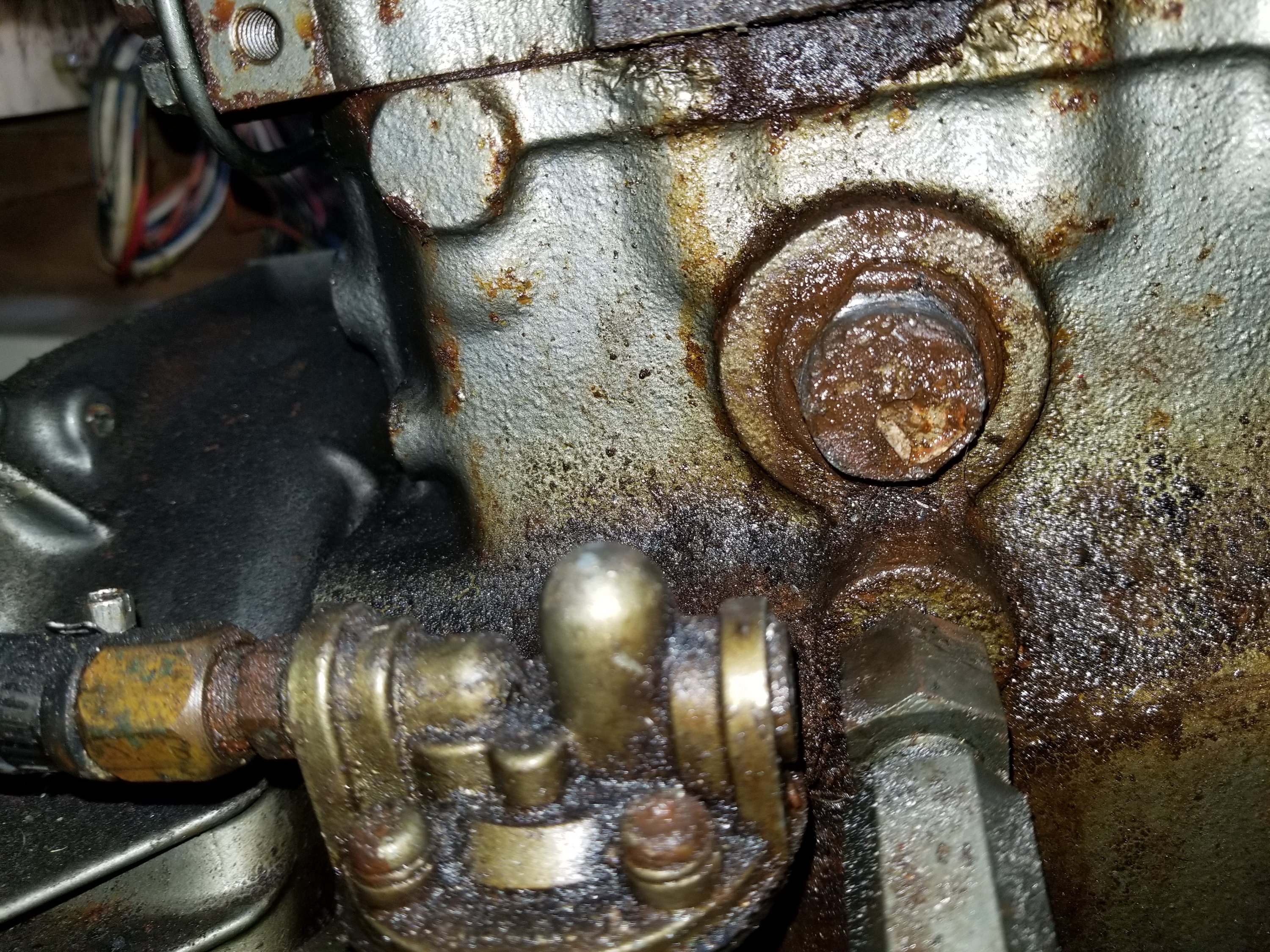

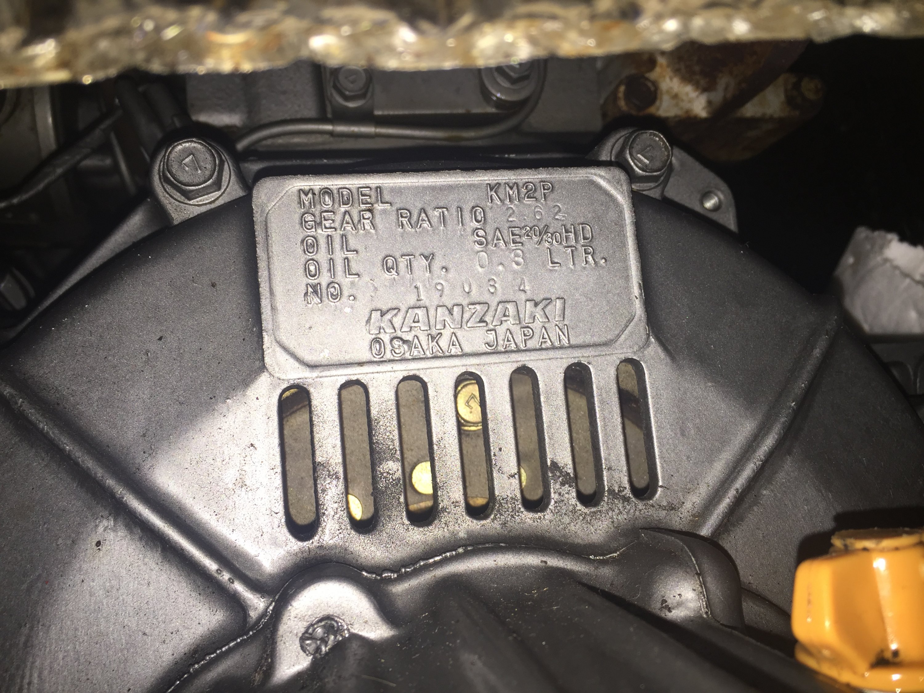

Both awkward and depressing. Had to stick my cell phone along the starboard side of my engine to see how badly I had stripped the anode bolt with my impact wrench.
I use that tool at work and on the boat, all the time. Handy. The only thing, there is a whole new parallax error to learn.
First thing I would try is a Grip-Tite socket. They really work. If the bolt is too corroded you can try heating it with an arc welder. Get a good ground connection to the block by unbolting the ground clamp from the cable and bolting the cable directly to the block. Set the welder on about 100-120 amps. Chuck a 3/8" bolt in the welding stinger then short the 3/8 bolt head to the stripped head. Tap it on and let the welder buzz for a minute or so. This will put the heat directly into the frozen bolt. Once it is warm go to work the the Grip-Tite. The welder trick really works. In a couple of cases when I have not had a welder available I have used jumper cables to the house bank. I would not try that on such a large bolt unless you have some really heavy duty jumper cables. They get hot in a hurry.
I was wondering about the parallax error but for what I'm doing close is good enough :) The anchor light I'm looking at is 2.13" diameter and I have about 3-1/2".

How did you get it out?

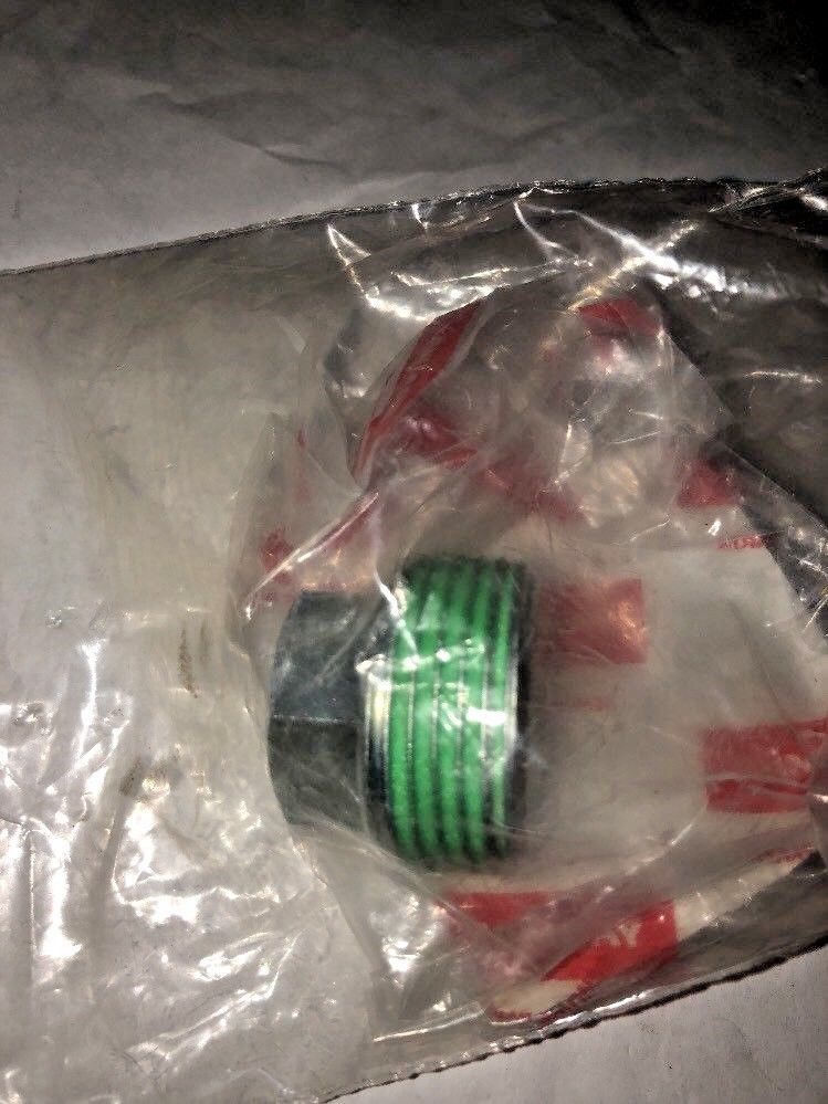

It is still in there. Ordered a replacement anode base Yanmar 128270-09300, and once it is here, I will be trying heat. Either welder or torch, and a nut/bolt extractor.
2018-03-25 17.43.31.jpg Yanmar 128270-09300 Anode Plug.jpg bolt extractor.jpg
Still worried as this is right next to the fuel lift pump which is attached with two bolts that may also be too difficult to remove. LOL
Have you loaded it up with penetrating oil? When I pulled the exhaust flange off my boat I sprayed it with Liquid Wrench every couple of days for a couple of weeks before trying to remove it. When I put the impact wrench to the bolts they came out in one piece. They were reluctant, but they did come out. I don't have any photos of the bolts, but they looked pretty much like the rest of the exhaust which was pretty rusted.
View attachment 148586 View attachment 148585 View attachment 148584
Be careful of the liquid wrench or any other penetrating oil. They will destroy engine gaskets and cause new issues.
