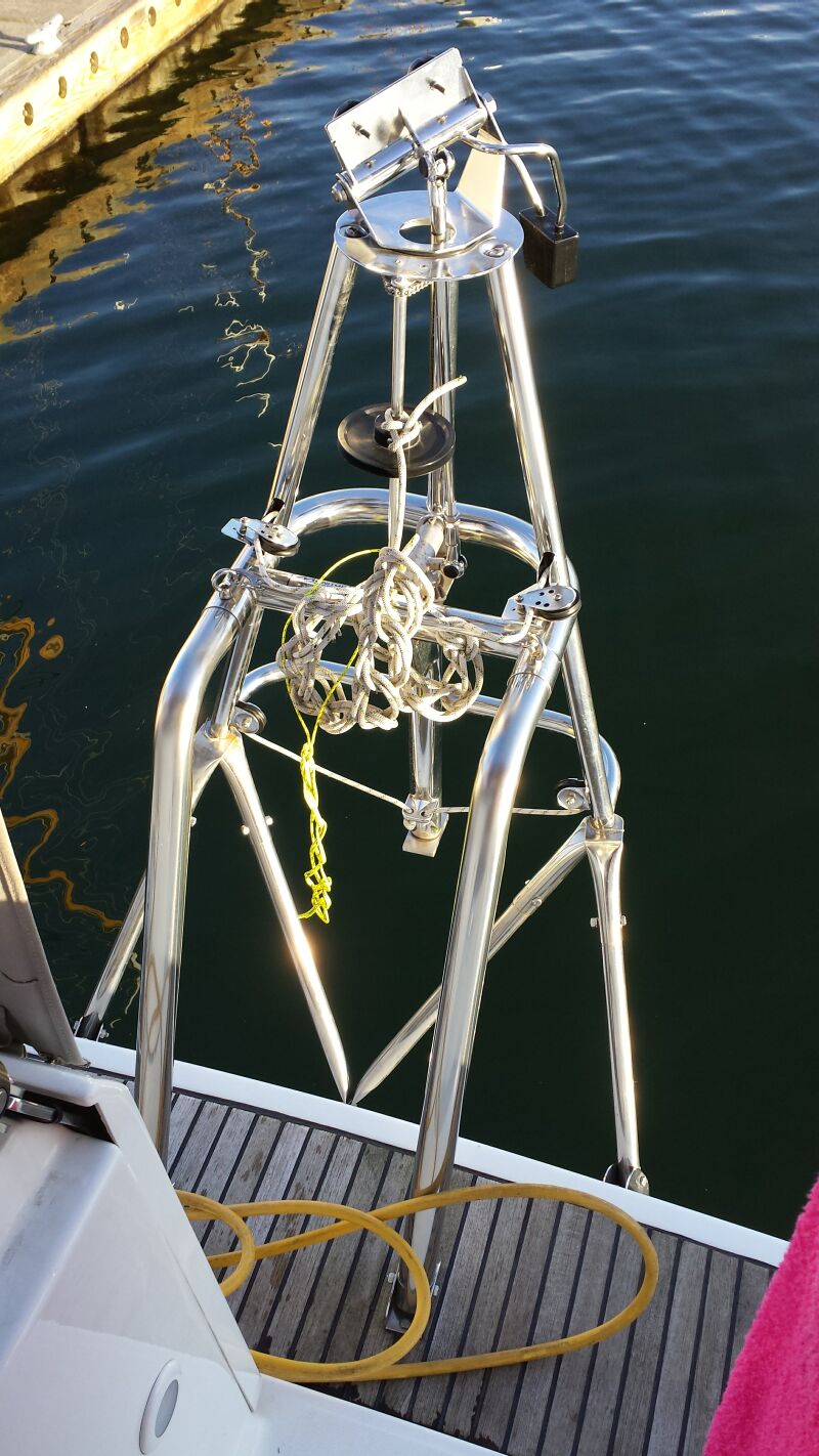

I got my Windvane from a Beneteau ( less than 10 years old) new to him owner. It was designed for the sugarscoop deck. He found it in his way after a season. I got all the extra SS piping and will cut it down with much left over.
Can be done but not for every person or style of use.
I would think you could look at what is being used in fishing boats. They have the type of wet environ you describe and beef up the system to handle the conditions.
I know... heresy to suggest such on a fine sailing boat. But if it is good equipment and is hidden from view who will know.

I got my Windvane from a Beneteau ( less than 10 years old) new to him owner. It was designed for the sugarscoop deck. He found it in his way after a season. I got all the extra SS piping and will cut it down with much left over.View attachment 134826
Lucky you! I'd love to find a used one I could afford.
