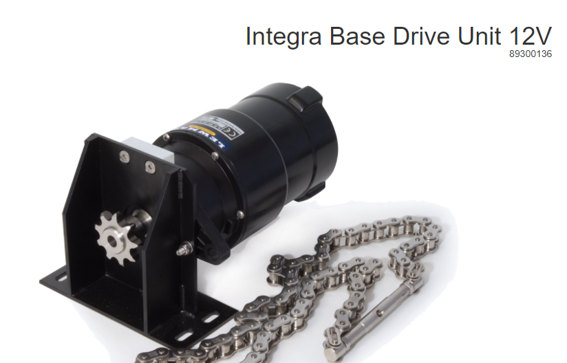

I have a 2006 Hunter 45 CC and my autopilot has failed. According to the maintenance lot the clutch spare kit went out and was replaced with a part number 89300141 in 2015 in St. Martin. I am in Mexico and the autopilot failed again. I found a man who rewound the electro magnet and it worked for 10 hours and then failed again. I have been in touch with Lewmar and the assure me that Integra 89300136 would be able to be dropped in and hooked up. However the ends of the two unit differ greatly. Has anyone had this problem and could steer me in the right direction. This is the model I have been told will work, however the end of mine has a gear not a sprocket. Here is a link to a photo of my autopilot IMG_5178.jpg
