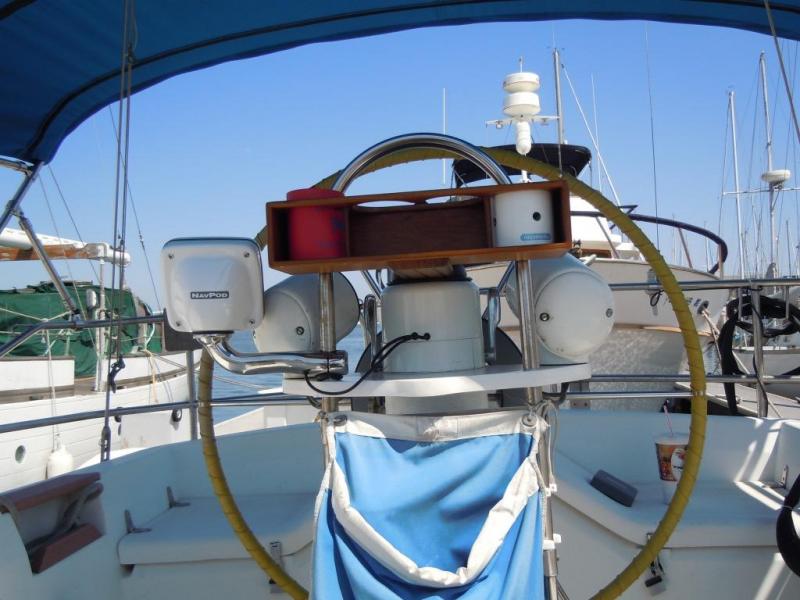

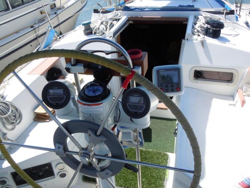

I added a swing arm for my autopilot display as I had no where else to mount it at the helm. It was a bit pricey (even from Amazon) at over $200, but it works well for us. We swing it around after taking that wooden GPS/Cup holder off and then can still use our existing wheel cover. Come to think of it, if we would have had to make a new wheel cover, then it wasn't so expensive.
Both of us can reach and see the AP controls easily.

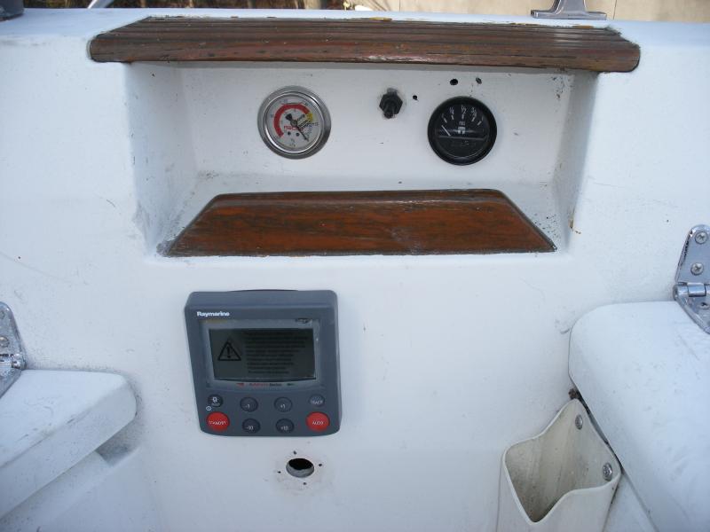

I made an error by installing mine right below the helmsman's seat in the forward lazarette bulkhead. My thought was that I could then see the display when sitting on the side seats or from in the cabin. If I were to mount one today, I would put it in the little cubby in the cockpit combing just to port of the wheel. I am going to install oil pressure and water temp gauges there next week. My Garmin chartplotter is where Allan's autopilot head is.

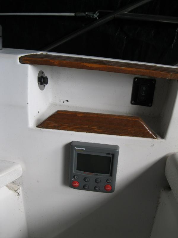

I replaced an ST-4000 with an X-5 and mounted the control head where the old ST-4000 was located: on the starboard side of the cockpit footwell below the cubby pocket. It can be seen standing or sitting at the helm. There is an LED cockpit footwell light now in the hole below the control head.
See pix...

I mounted mine in the cubby just above where Dan put his. It just fits and this keeps it out of the weather. Little bit awkward to see but not a real problem. I needed to put mine near where the power plug was for the old 3000 to save re-wiring.

Interesting. My boat doesn't have that chrome bar that you have everything mounted on. Just the white pedestal with the Wheel attached and the compass on top. Maybe that's what I need.
See pix...
That could have been a picture of mine. The only issue is when I walk by and bump it with my knee and turn it on or off. I have a fix in mind for that though.

Kloudie - I have decided to mount engine instruments and autopilot in the same combing compartment. I have the board cut and ready to epoxy before I apply a black laminate. Please post some pictures of yours if you have time. Thanks.

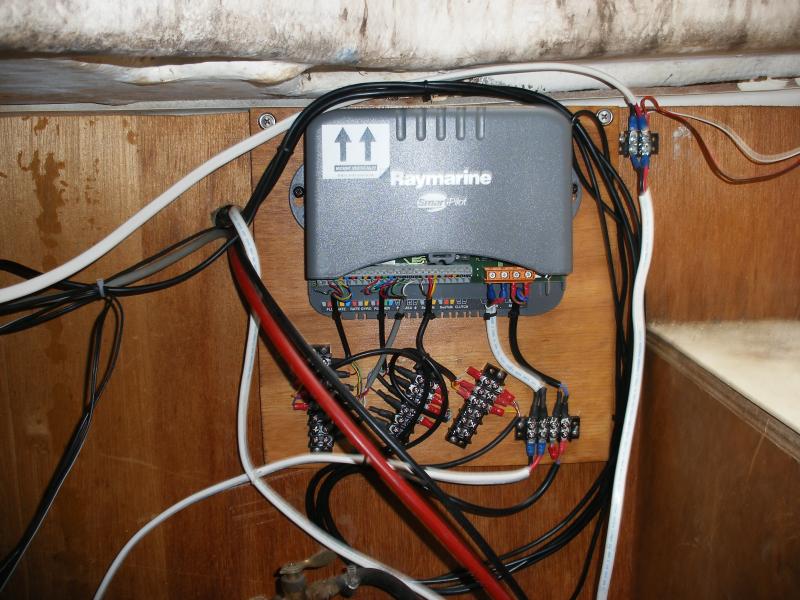

My installation is like Dan's and my findings are pretty much the same except I did not seem to have any problem with adjustments and I don't even have the rudder sensitivity instrument. I do adjust the sensitivity of the pilot itself on the control head (Raymarine defaults it at 5 and it annoyingly returns to that setting everytime the AP is shut down). I installed the computer box under the coaming (hours of pleasure in the lazarette) and it has prooved a good location as it is out of the way and protected from the elements at all times, keeping wire lengths at a minimum.

Autopilot computer location...
My computer is in the same locker as Claude A's, but against the aft cabin bulkhead. See pix...
I failed to correct myself earlier--This is an "S-1" model, not the X-5. It's the one that has the both the rudder sensor and fluxgate compass units to mountl. The difference is probably a chip on the motherboard.
