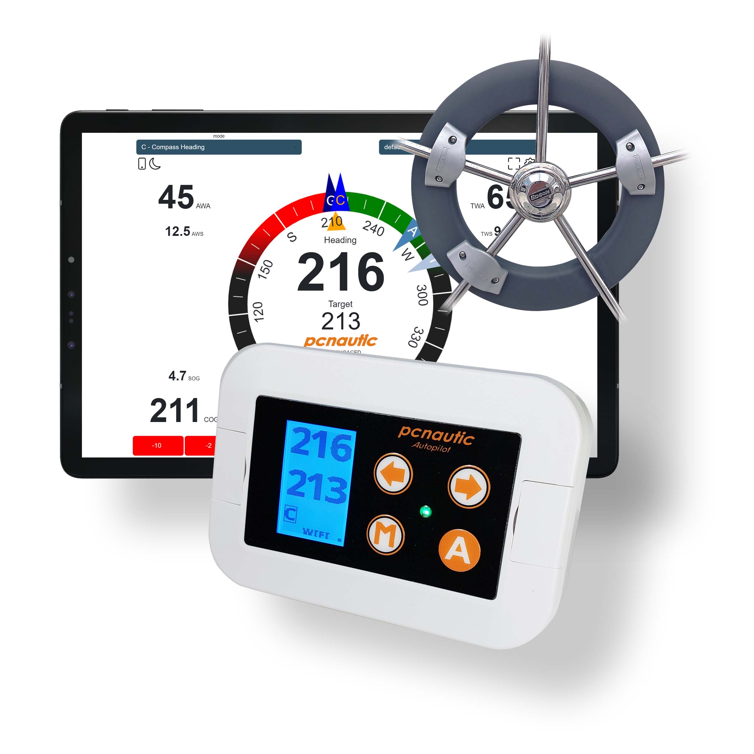

Check out the PCnautic - I think it is much better:
I am running the tiller pilot and can wholeheartedly recommend it.
The wheel pilot uses the RM ST4000+ (16.500lbs) - maybe they are open to replace this with the larger ST6000 upon request?

I don’t think Raymarine makes a heavier wheel pilot. The motor drive and wheel are pretty much the same for past 20 years (minor “improvements” over the years). I went from a ST 4000+ to a ST6002 and the wheel drive is essentially the same. The latest version - EV-100 - uses the same wheel drive as the ST6002 I think.
