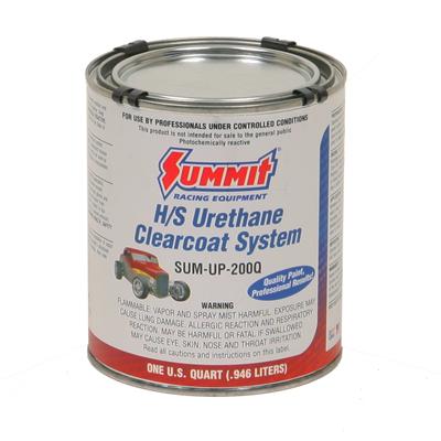

I think when we leave the boat this time we will try two test areas next to each other. On one we will take it back down to bare teak and use the Armada again. Next to it we will do the same with the Armada, but try 3-4 coats of an automotive clear urethane....
http://www.summitracing.com/parts/sum-up200q/media/images
...over the Armada and see how it looks when we come back. I'm hoping then that we can scuff it and put on 1-2 more coats of clear annually. I've sprayed the clear before. I guess I'll have to see how it goes on with a brush. I'll probably have to play with the amount of reducer I use. On a car this clear really lasts.
Has anyone tried this approach?

Heavy build up of clear urethane usually wind up cracking with age.
Wood is an organic which changes dimensions with age and water absorption content; if your coating is 'hard' such as an alkyd enamel base (Cetol) or urethane base (Bristol) it eventually will crack. Even varnish, that becomes embrittled with age and sun exposure will crack.
My experience with Honey Teak (A urethane-acrylic co-polymer system) is: it remains flexible for up to 12 years even with THICK coatings, has sufficient UV blocker to prevent destruction of the surface wood cells (now supposedly has enhanced nano-sized ferrous oxide particles for UV blocking) .... but after 10-12 years, it too has to be stripped when it loses its 'flexibility'.
HT needs an occasional 'clear coat' maintenance to look 'dazzling'; the clear coat doesnt have any UV blocker, yet can be power-buffed (w/3M Perfect-it™, etc.) instead of 'overcoating' every ~2 years ... keeps the clear coat thin and flexible, hence no cracking.
HT is best applied in cool/cold weather to allow best 'flow out' and 'flatness'. HT is probably the MOST expensive of all the marine coatings, but when you amortize over the years it turns out as the cheapest in cost and TIME. There is a VERY high learning curve with Honey Teak, to get it 'right'.
Even automobiles with clear coats will usually need restoration of the urethane clear coat after 10-12 years, sometimes sooner.

Sprayed the wooden mast on the boat over 4 years ago with acrylic auto clear coat. Boat has been over 7000 miles cruising since and mast still is perfect- not a crack, not a flaw.
Problem was it HAD to be sprayed- dried way way to fast for brushing. Ten minutes and the next coat could go. Did 4 coats in an afternoon, sanded next day and shot final.

I bought a vintage Wagemake Wolverine from a guy who "Wanted to finish it one last time to last forever". He had sprayed it with multiple coats of automotive clear. It was beautiful, but it scared me, so I always kept it indoors and dried it thoroughly the couple of times I used it. I had a money-making opportunity so I sold it to a doctor friend. He kept it under a tarp at his spot at the lake. In 6 months the finish was gone, flaked off from wood movement.....
My advice is to NEVER use automotive finished on outdoor wood. my reading and experience says it is completely incompatible.

I guess my question is what is the difference between the urethane clears that are used in some of the boat products vs. the auto ones? It sounds like in the case of the mast above the automotive worked well.
I'm wondering how some of the small places that are supplying the marine products are developing them and producing them with the large overhead that the major paint companies have doing that?
As I mentioned I don't have the confidence to do the whole boat, just a test area and I will report back on the results whatever they might be :),

Note that I said ACRYLIC clear coat. There is a difference in products. The stuff we used is made by Dupont, who makes Imron paints. I can get the product names tomorrow.
