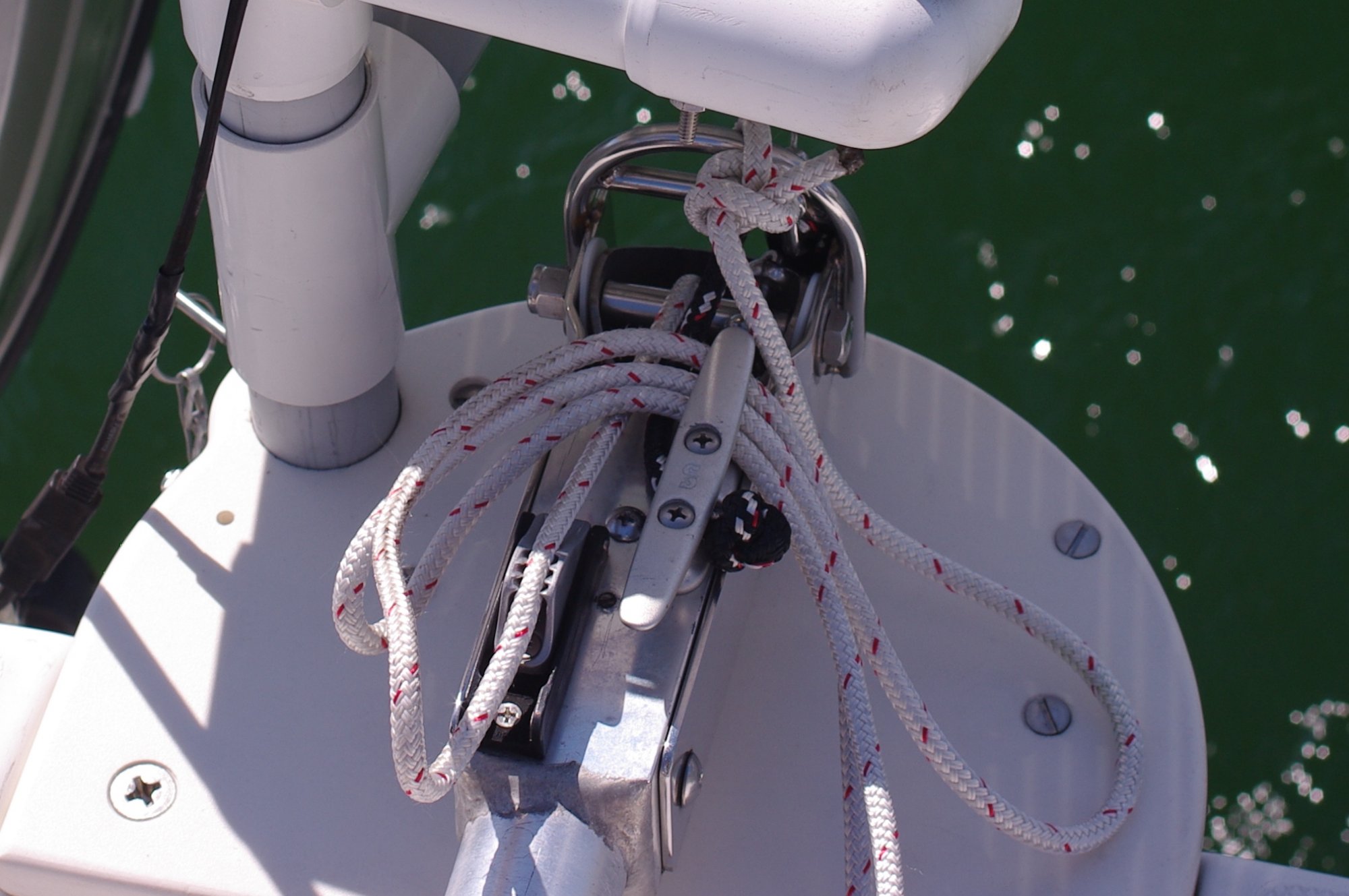

I was looking for a cleat to replace the standard 4" one on my tiller that keeps the rudder in the down position on my H240 I found this one.
It is a CL257 Auto-Release Racing Mini. Does anyone have any other recommendations?

Hi Pat-
There is a write-up on that rudder cleat in the 260 modifications, here, works same on a 240:
Hunter 260 Owner Modifications and Upgrades (sailboatowners.com)
I put one on my 240 and it worked great. I left the original horn cleat to use with the uphaul line when trailering, although you don't really need it if you use the locking pin when raised. Here's a picture, white line is downhaul, black is uphaul.
Oh yea, mount it as far forward on the tiller head as possible to maximize the leverage the line has- so it will release as designed.
