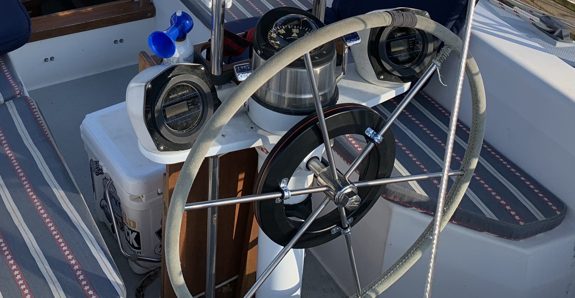

The wheel clamps For the autohelm ST4000 on my steering wheel snapped. I need to replace them but I can’t seem to figure out what size. Has anybody replaced these clamps on the original autohelm? And if so, what size and where did you get them from? I’m not sure what to measure on my steering wheel to find the right ones.

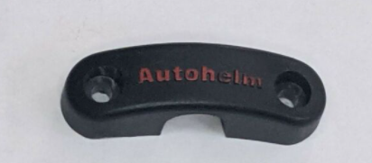

There is quite a variety of sizes. None of the ones for sale were the right ones for my boat. I found a fellow who is 3D printing them. They work. I came across his add while searching EBay etc, since they are discontinued and out of stock. At least for the 4000 series.
One of mine failed while out sailing in benign conditions. Just 20 years of UV exposure.
