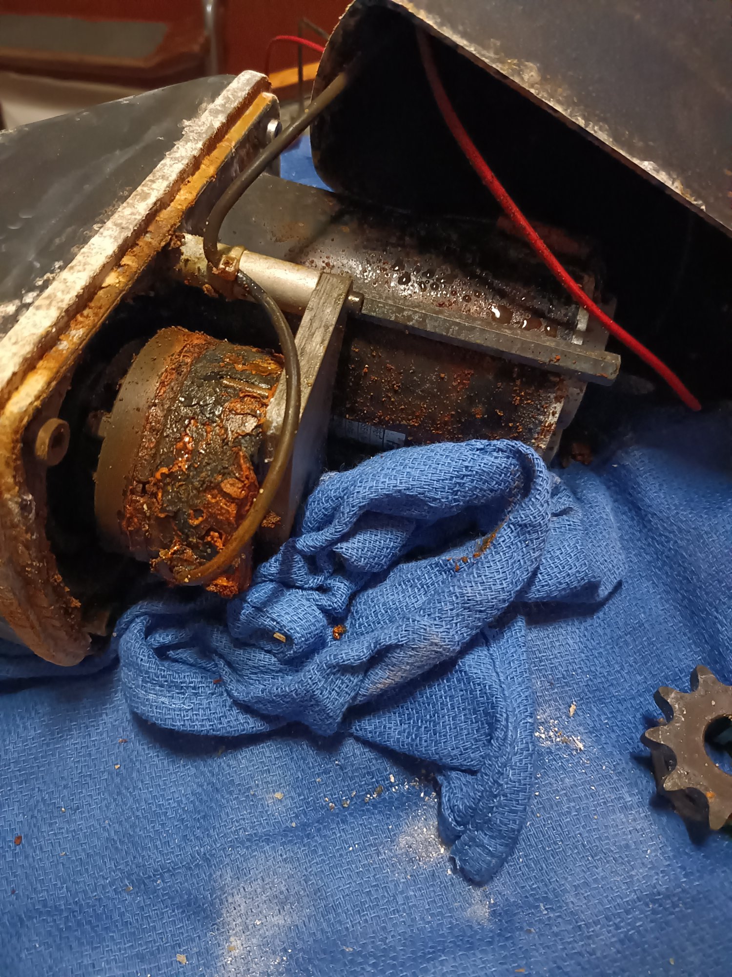

A new owner of a 1991 43'. The autopilot was/is inoperable, the clutch would grab but no rotation, so I finally tore apart my helm to get to the drive unit.
it's in really rough shape but was working up to a few years ago (according to the previous owner) so it must be a very good drive unit. another issue is the display LCD is partially unreadable.
I don't want to spend the money to refit everything, but as this stuff ages, repairs become almost as costly as new systems.
is there a hydraulic rotary drive unit that will fit without modifications? or should I just replace the autohelm drive?

What autopilot do you have? The current one looks to be at end-of-life. You will not be disappointed with a new one fit-for-service.

Surprizing amount of corrosion, hope mine doesn't look like that.
I'd replace with the same, it's expensive though.

thank you everyone, I'm going to just buy a new type 2 12v drive unit, but surprised a couldn't find a rotary hydraulic drive unit to convert to. I know my type 2 was working at least 2 years ago so 30 years is a good indication of the quality and cheaper/easier than a whole new system. my biggest concern is keeping it going as the components get harder to find.
