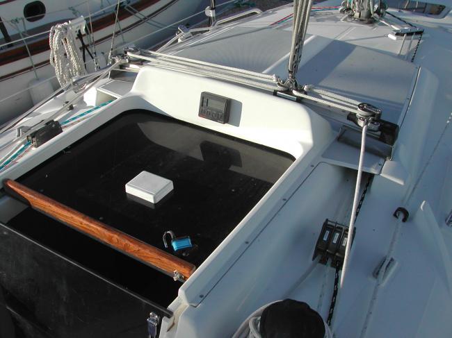

I need to remove my BiData display on my Hunter 280, but don't see a way to get to the back of it. Any thoughts, ideas, or suggestions would be much appreciated.

You will need to lift the panel it is mounted to. There are two knurled knobs that secure it from the back. Looks like you could remove the screws on either side of the companionway hatch cover and slide the hatch out of the way. That should give you room to put your hand behind the panel.
