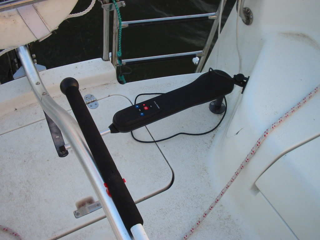

Location worked best for me. Out of way of outboard. Also, easy to run fused 12v DC power receptical directly from the battery to the rear side of port seat.

Port side
Installed mine on the port side as well. Like you said, keeps it out of the way of the motor and it's easy enough to lift it off when you want to use the ladder. Use it on almost every sail. Ron Mehringer Hydro-Therapy

Parts List
Got it from Sail Net SIMTB120 Tiller Bracket 4.72" SIMPB90 Pedestal Bracket 3.54" SIMTP10 Tiller Autopilot Used a Power plug Receptical that I got at Wal-Mart and a plug that I put on the Autopilot from Radio Shack. Changed the angle (bent) on the Tiller bracket so that it lined up better. Put it on the tiller with a couple of stainless straps until I was sure it worked the way I wanted it to before I drilled it. I'll try to take a couple more pictures and post on project section. Hope that helps you.

Starboard Side
I used a Raymarine ST2000+, and mounted it to the STARBOARD side. Also, I did not use the pedastal mount - I can see me breaking a toe on that one! I used the bulkhead mount, which looks almost the same, but mounts against a vertical surface. I bolted it to the vertical side of the bench seat - the part angled back near the motor. In addition, I used the angle bracket, similar to the picture, but I made a spacer that was flat on one side and cut a channel the same diameter of the tiller on the other. Made it out of a piece of Trex. Then, when I bolted it, I drilled 5/8" holes in one side of the tiller, and smaller holes (~1/4") for the bolts in the other. This way, I could get a socket through the big hole and really crank down on the nut. If you run the bolt all the way through the tiller, you can't tighten too much or you'll start to crush the tiller. For the record, I do not find that the starboard side mounting interferes with the motor at all. I can also leave it set-up and connected when we're at anchor and not have to move it to use the ladder. As an added plus, the autopilot will hold the rudder centerline while we're anchored without having to lash it in place. This was the best option by far that I've added to the boat. I keep kicking myself for not adding it sooner!
