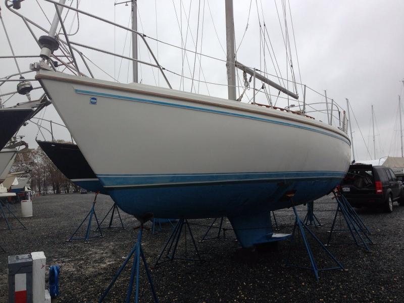

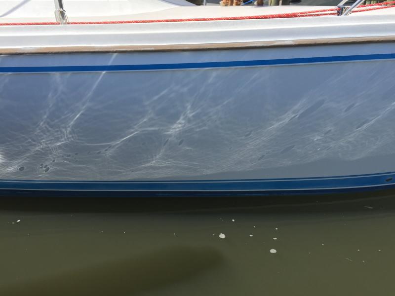

I also followed MS's steps just last month but 1) did not introduce any water during the compounding or polishing and 2) cleaned the pad w/a wood stick after completing each section (4'w x 1/2 hull height). Here is the before and after. I'm still clicking my heals with pride seeing the water reflect off the hull. Before there was nothing. Bonus was the hull stripes came back as well. Now it is time to tackle that 28-yr old neglected deck. The rub rail will be replaced afterwards.
