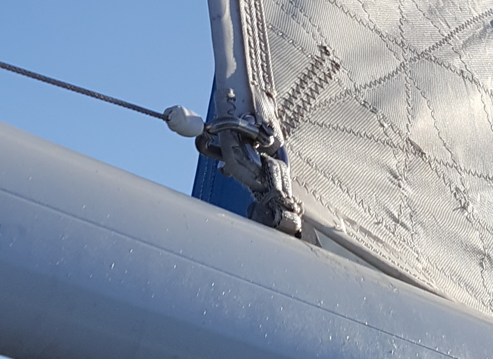

All boom-end attachments are becoming straps, including the mainsheet. Here on the VOR65. Look for it in everyday boats in a few years...

In the particular case that you show in the photo, is that a carbon fiber boom? If so, then it would make perfect sense to me that a strap would be a good option. Fastener joints are frequently the weak point in hybrid carbon stress members.
I'm not immediately recognizing a similar advantage from using a strap on an aluminum boom. Do you expect the strap trend to expand into more traditional aluminum stress members? Or do you expect aluminum to go the way of the dodo bird? Or am I just missing something?

Correct, it is a carbon fiber boom.
My comment has more to do with the general trend that is moving from medal fasteners to textile ones. Even on cruising boats like Jeanneau 35 footers, you'll see dyneema soft shackles, dyneema/rings and webbing in place of lbs of stainless.
A 2nd benefit of the loop is that it lowers the top block. Not a huge deal with a 2:1 like on the V65, but this 6 inch dyneema strop saves us 3 feet of suspended mainsheet!

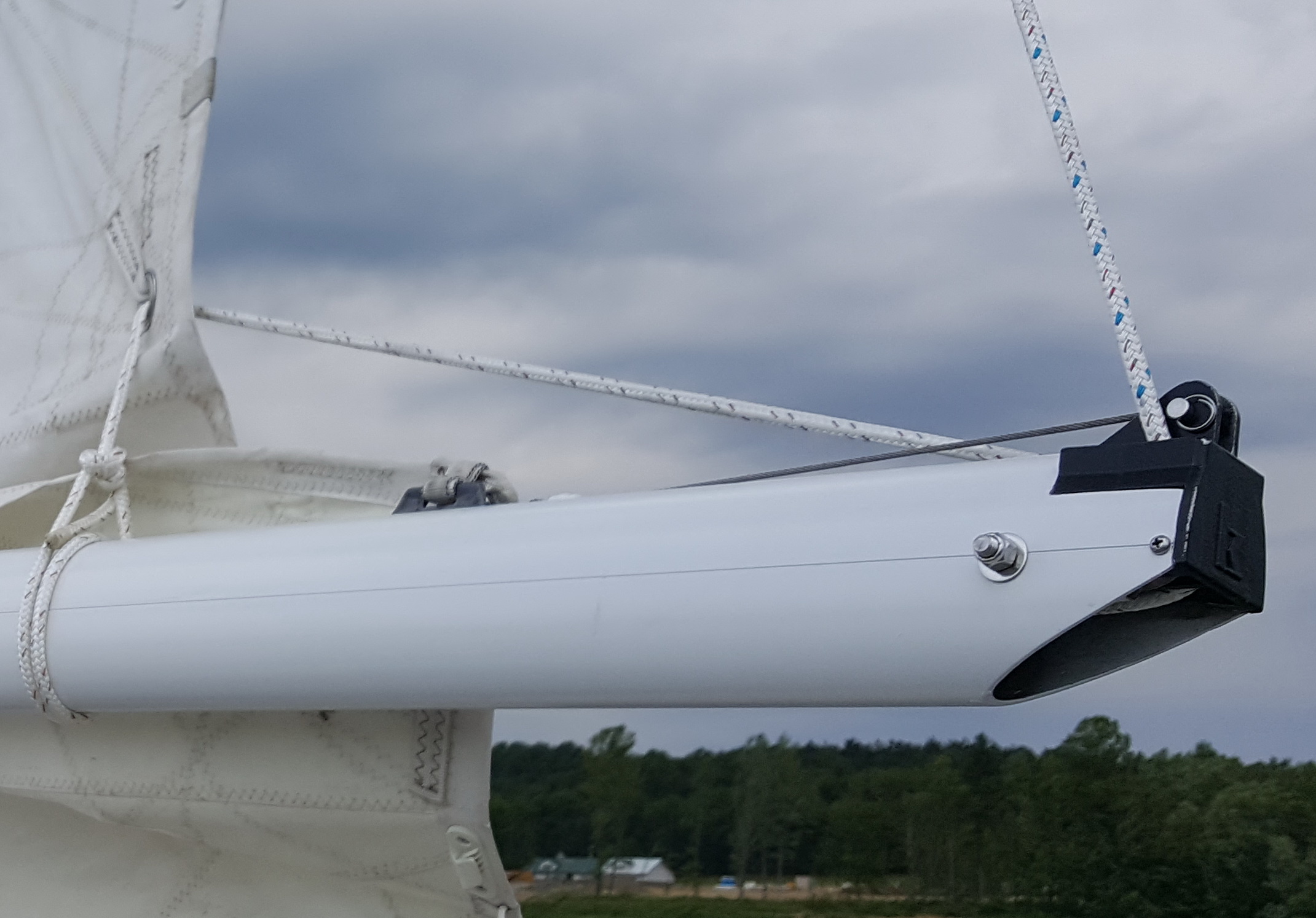

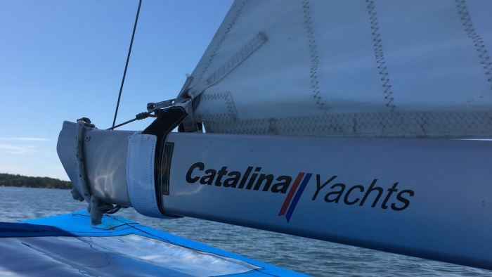

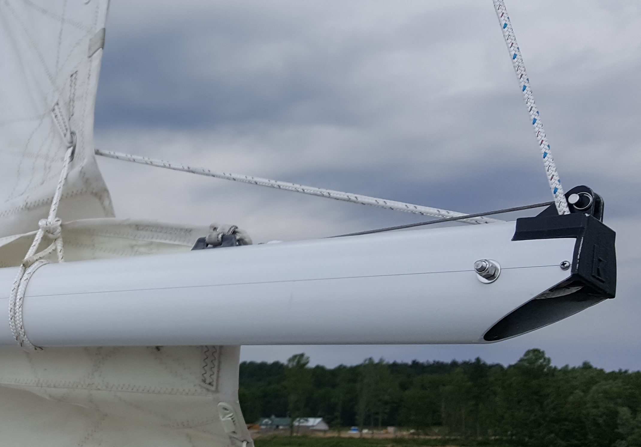

Aug 1, 2011
3,972

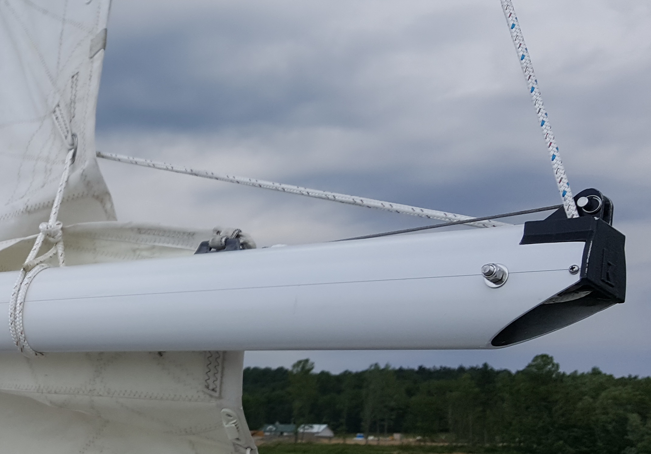

It's also about ease of use of the hardware. The slug in the slot of the boom is almost an interference fit when the sail is loaded up and makes the outhaul hard to work, reducing it's effectiveness as an available tool for sail shape. With a strap, the off center load that can happen is absorbed by the strap, and it still slides like butter. (and this ain't no carbon fibre racing sled)

How is that connected to the boom so that it cannot slide fore and aft?
A short length of webbing is attached to the top of the boom, over the loop.
