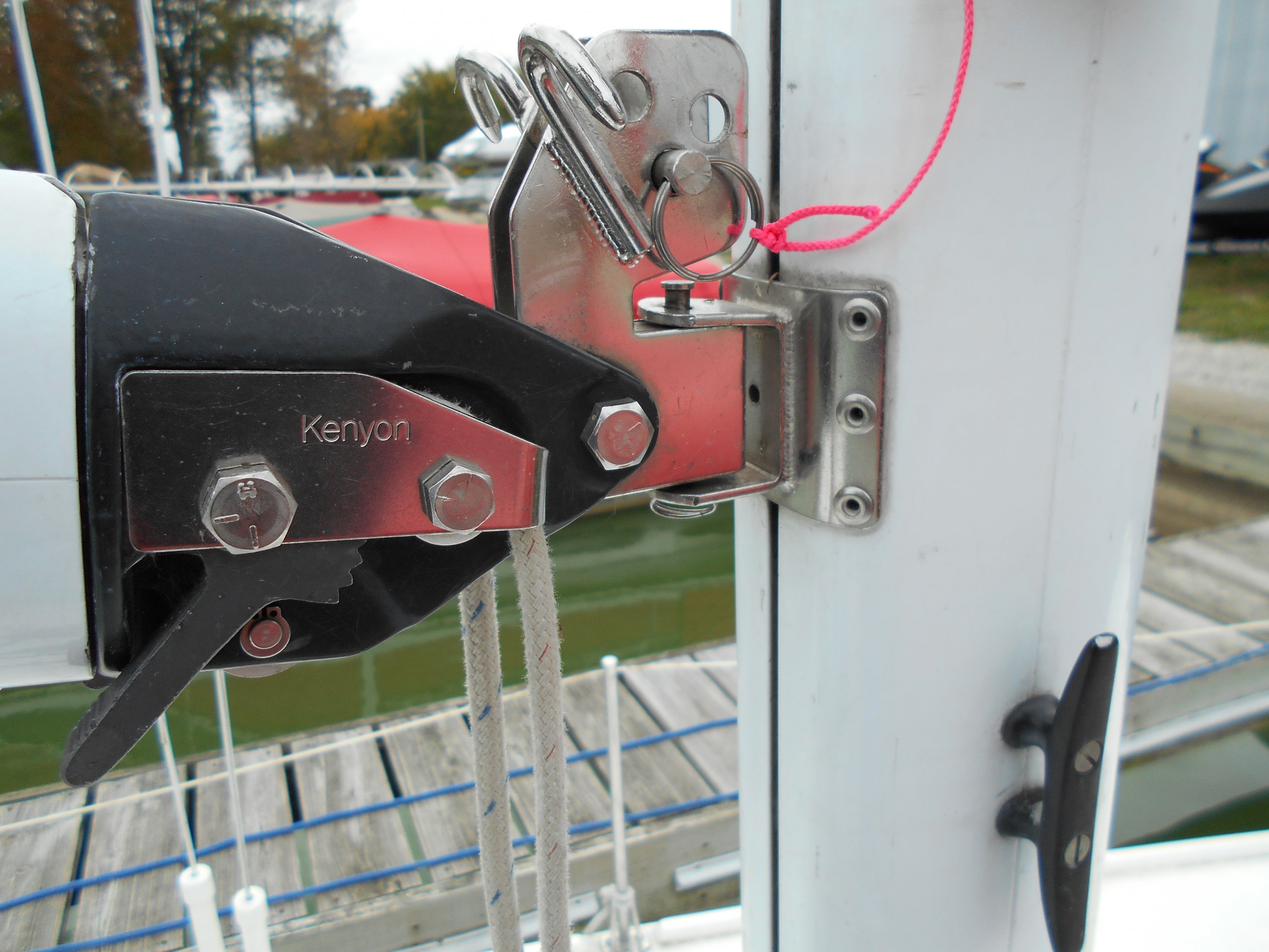

The boom was built by Kenyon Isomat which later became Charleston Spar and now Sparcraft. Parts are supplied by Rig Rite and if you will search, you should find a photo of the attachment for it.
Mike, thank you for the photo. However there was a different attachment style for the hooks which I am not sure what you have, this style or the older style.
@Sea Horse Take a photo or two what you have then we can go from there helping you.

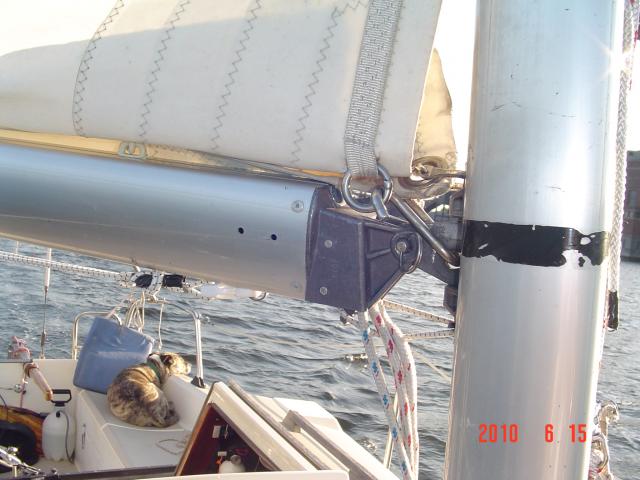

Yes, a photo would help. My H23 ('91 hull) has a different gooseneck than the photo above. I am 3 hrs away and it has a cover on, so it'd be difficult to take a photo. On mine, the fore end of the boom has a cast aluminum fitting which has a horizontal hole, and the mast gooseneck has a fitting that is also cast and has a "slot" that the "male" part of the boom fitting goes into, with matching horizontal holes. There should be a pin of some sort that holds the two fittings together. On mine it is a stout aluminum tube with outer diameter to fit the holes in the fittings. The tube is about 1/2 inch longer on both ends than the distance between the outer walls of the "female" fitting on the mast, and is drilled diametrically on each end for a decent size cotter pin. You remove one cotter pin to install or uninstall that pin/tube. Perhaps you are missing that.
I suppose any sort of clevis pin that is long enough, the right diameter, and has a head that blocks it from sliding through would work. Measure the diameter of the fitting holes and maybe a hardware store has stout walled aluminum tubing you can use, that you could just cut to length and then drill for the cotter pins. You could even use galvanized in a pinch, but I'd get rid of it soon so you don't get rust stains.
UPDATE: I found a photo that looks like mine. If you have this, see if the "pin" is missing; it has a split ring on one ned in this example.

Mike, That is exactly what I have. Now it all comes together for me. Thank you for the picture.
