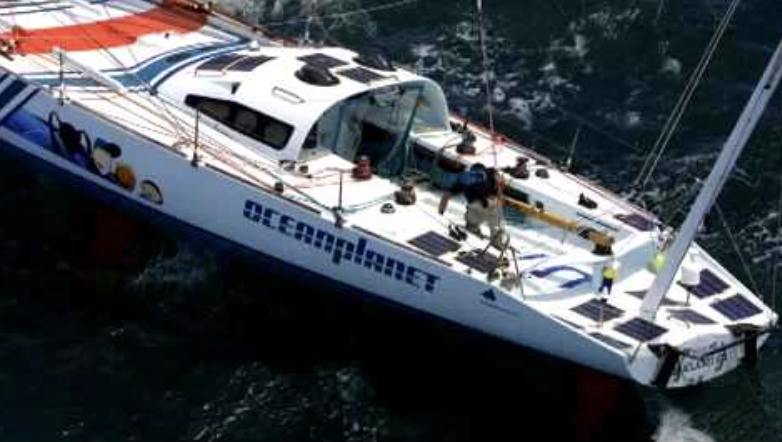

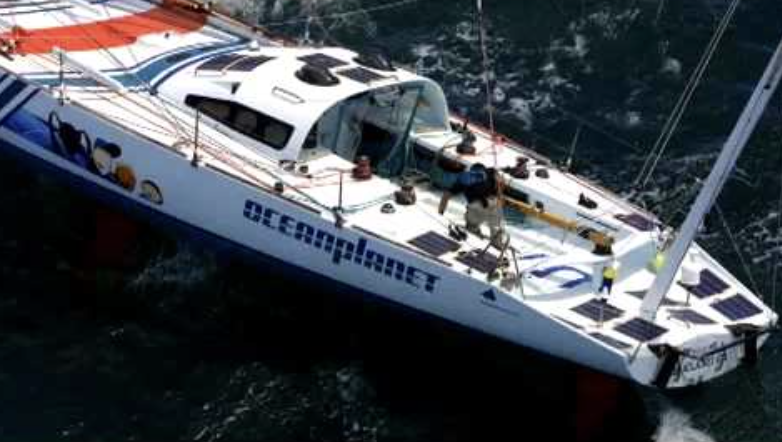

I would use VHB tape. Will hold fine and you can break the bond with a thin pry bar. Bruce Schwab who has been installing solar panels on ocean racing boat decks for decades (including his boat in 2005 when he was the first American to finish the solo non-stop Vendee Globe round the world race). If heat was a problem - he'd mention it. Solar Installation Guide & Accessories | Bruce Schwab - Ocean Planet

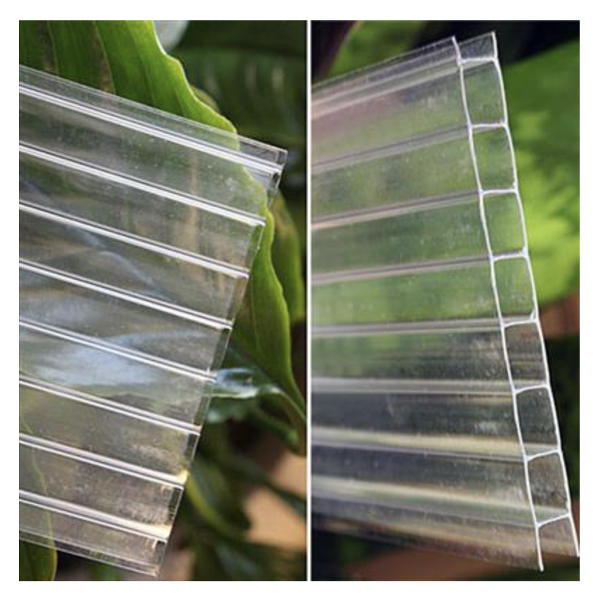

Another option is to get some twin wall polycarbonate panels from a greenhouse supply place. These can be cut to the size of the solar panel. I use this under my bimini mounted solar panels to avoid a hard spot at the bows. They flex enough to follow the curve of the bimini but not so much that the solar panel can be damaged. I attach the solar panels to the polycarbonate with VHB tape.
