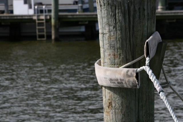

Eye Splice w/ Chafe Protection
Here is my solution . . .
I am backed in along a full length fixed dock along the port side and at the stern. There is no dock on the starboard side. I use fenders boards outside of 2 vertical fenders at 2 locations where pilings support the dock along my port side. The starboard bow line (pictured) is around a stand alone piling.
At the bow I use a 3/4" - 3 strand nylon line with the fire hose to protect against chafing. (The double braid in the picture is the boat next to me.) At the bow I have one line around a piling on each side with the running end secured to the bow cleats. I have crossed stern lines and a single spring line on the starboard side. The boat lays about 1 foot off the dock on the port side.
Normal tide range is 2 feet but we have had some outrageously high tides here on the Sassafras over the past week. I have not needed to adjust my lines.
