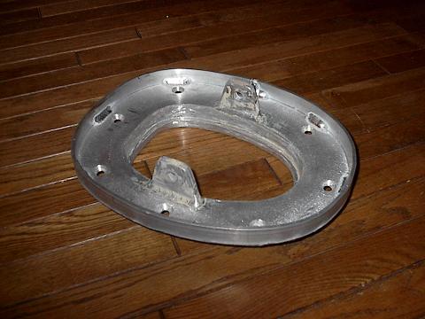

...is to weld a ring of aluminum flat bar around the perimeter of the mast collar base. In the attached photo, you can see some tack welds, but the whole thing is tig welded around the bottom as well. Once I bed this on the deck and attach a good dacron mast boot, I think my mast leaks will be banished.

Nice fix Jim.
Your collar with a proper boot should definitely work. It would not work for me though because of my use of the partner bolt holes for eye bolts. I think I am stuck with just piling on the silicone.
