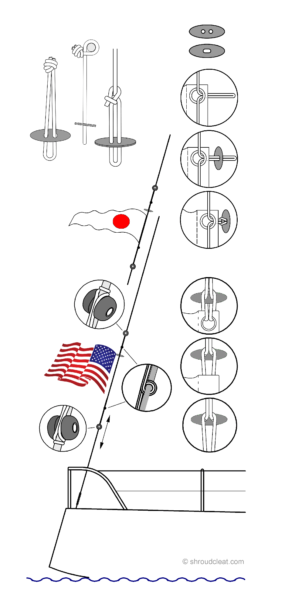

Wow Ward, a very serious issue indeed. A good old toggle and a button shroud cleat might be a safer option to attach a flag or burgee?
