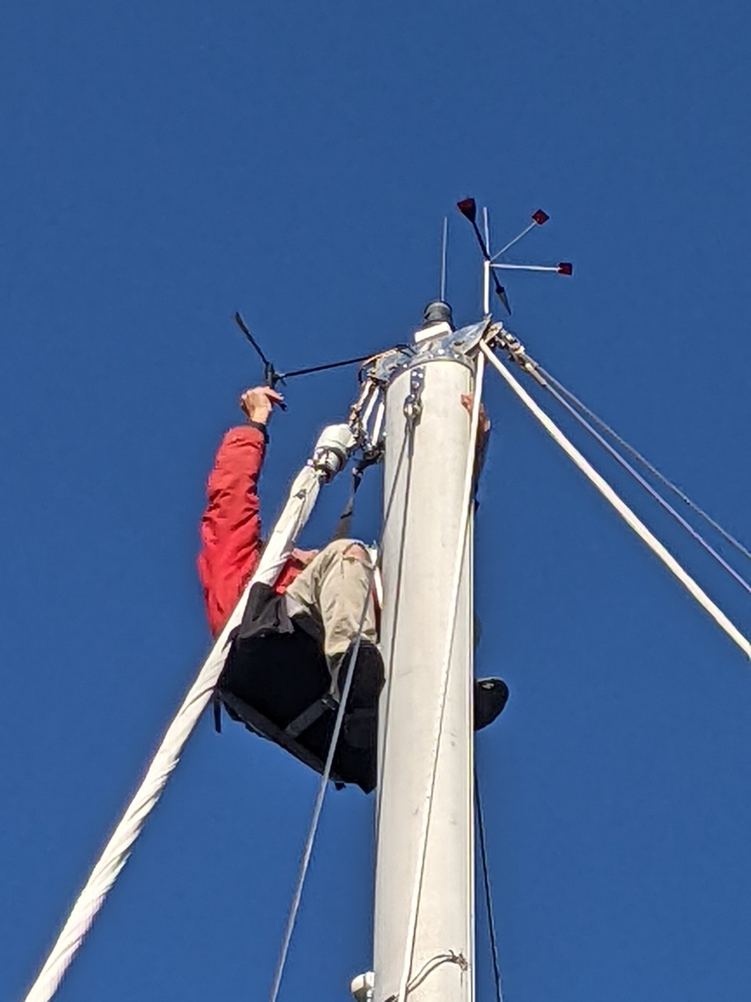

Got pictures of how you set it up? Are you using a bosuns chair?
Here's a picture of a friend of mine working at his mast head with a pair of ATN climbers - notice the bosuns chair and where the top ATN climber is located. You can't see the bottom climber in this picture, but you can see straps on his right foot.
dj
dj
