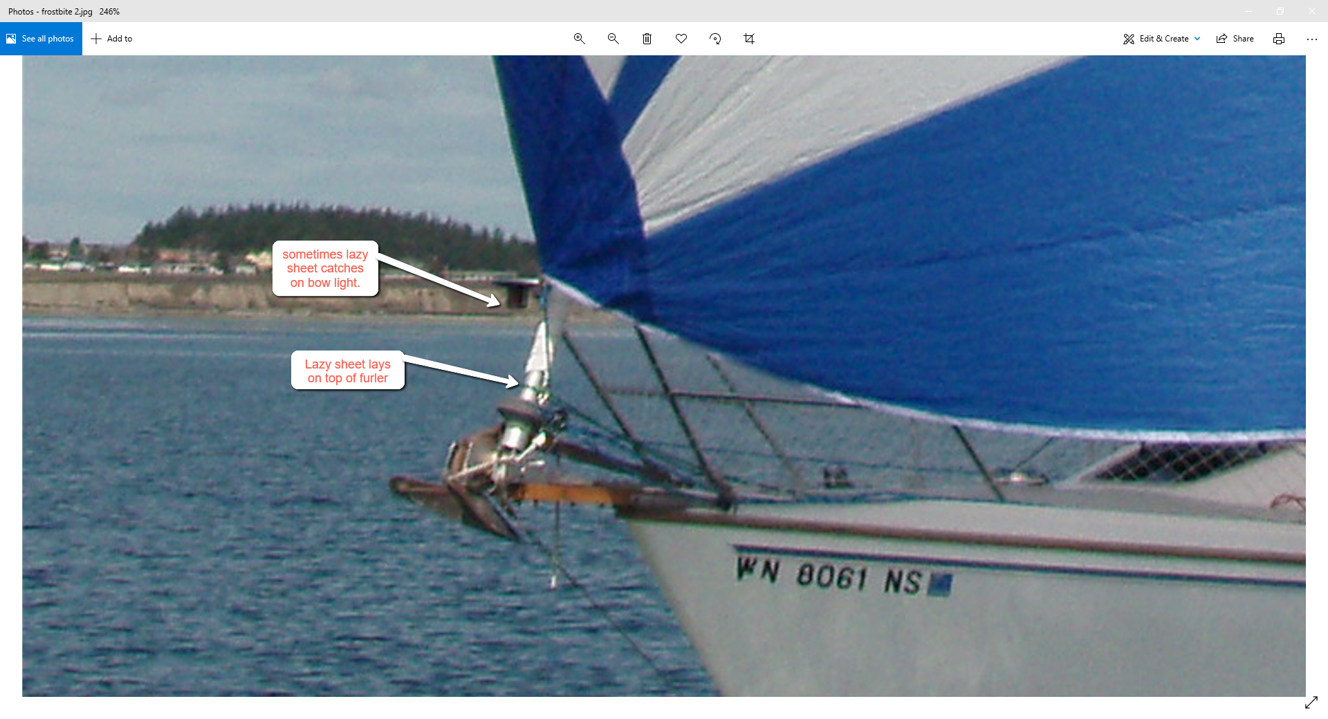

I typically set my Asymmetrical spinnaker sheets to do an outside gybe with the lazy sheet going outside the spinnaker and they lay over the top of the anchor. Most if the time, the gybe is
no problem with the sail flagging out in front of the boat and then pulled in on the new side. Every once in a while, the sheet will catch on running light on the bow pulpit.
Any ideas what I might do to prevent the line from catching on the light?

My A-sail is tacked outside of the forestay on the end of the anchor roller on the end of the bow sprit. At the mast head, I have a spinnaker crane that puts the halyard block about 4" forward of the forestay.
I have set up for inside gybes when buoy racing with sufficient crew but prefer the outside for sailing with a short crew because it does not need anyone on the foredeck to help the clew come across. When it does hang up on the light, I need to send someone forward to clear it but like I said, that doesn't happen every time.

I did add the batten to the luff and it works (sort of) but still does not prevent the lassoing of the bow light. That happens after the spin has flagged out in front and as the new sheet is being pulled in. I suspect that it might be caused by pulling on the line too soon. One thing I have thought about is to make a couple of small soft shackles that are sized to run between the ears of my Mantus anchor and the pulpit at the bow light. The problem with that idea is that it might make it more likely that the new lazy sheet would not get captured on the bow and would drop into the water and under the boat. This currently happens occasionally and I just release it, pull it back aboard and re-run the line. Usually the new lazy sheet drops onto the anchor and then I go forward and hang it on the batten.
