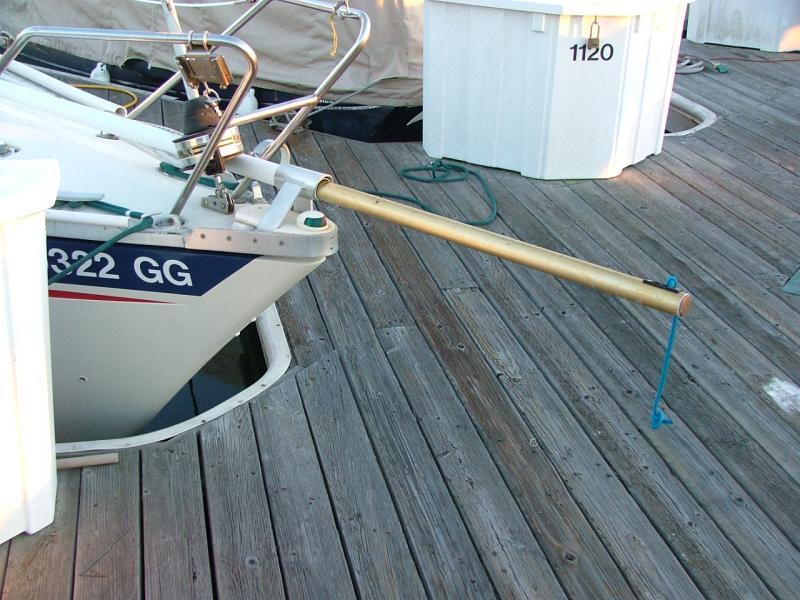

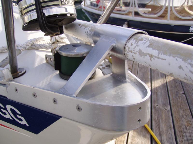

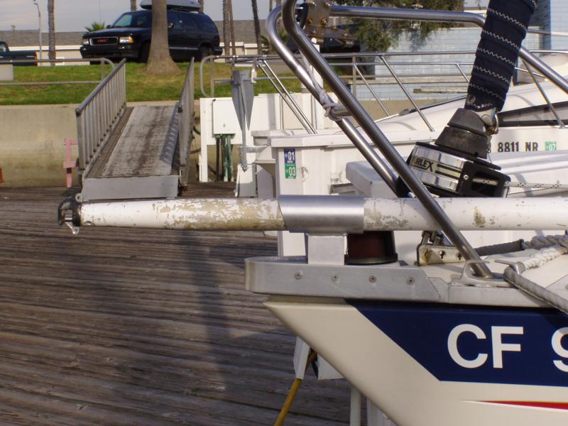

The previous owner of my boat had a extension bolted to the bow- You had to bolt and unbolt it to keep the marina happy and it was a hassel. I replaced it with a fabricated mount attached to the bow that allows a small spinaker pole to slide through. The aft end of the pole clips onto a U bolt mounted through the deck. this made it retractable. I believe SELDEN sells a similar system. the trick is the fwd mount.
I later replaced it with a retractable system, tube inside tube, that can be controlled from the cockpit. Both systems are limited as to strength with no downhaul below the pole to the stem of the boat. My tube in tube version being the weaker of the two. I have to flag the sail to change tacks as the sprit is only 36" forward of the headstay. I'd consider it a light air system.

Found these photos deep in my hard-drive.
This was the first version I built. Simple and strongest of the two. This required forward crew to deal with sail tack ect. I used a block/line to allow the sail tack to come aft for stowing. nav light is still visible from each side even though it doesn't look it.

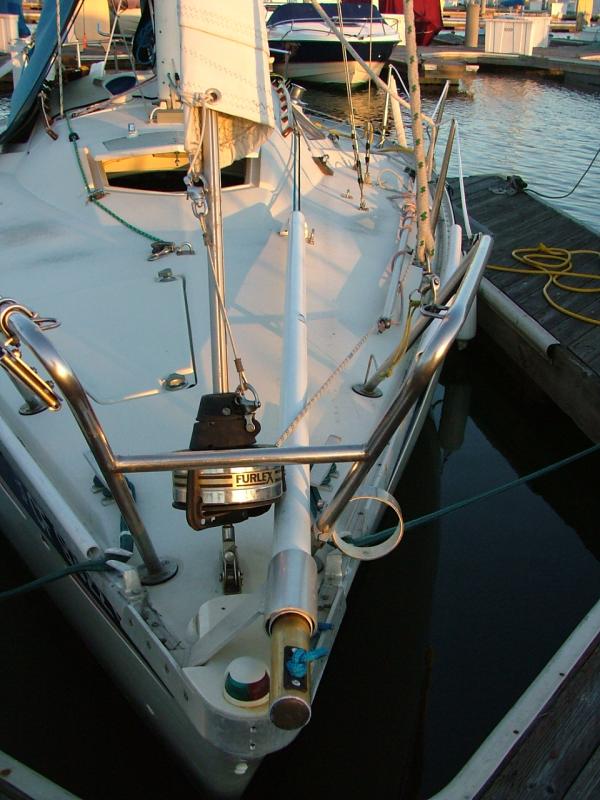

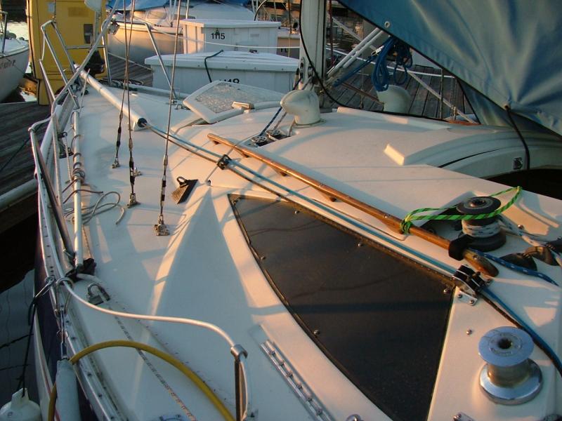

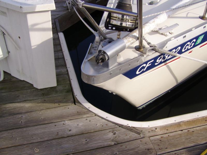

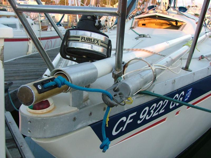

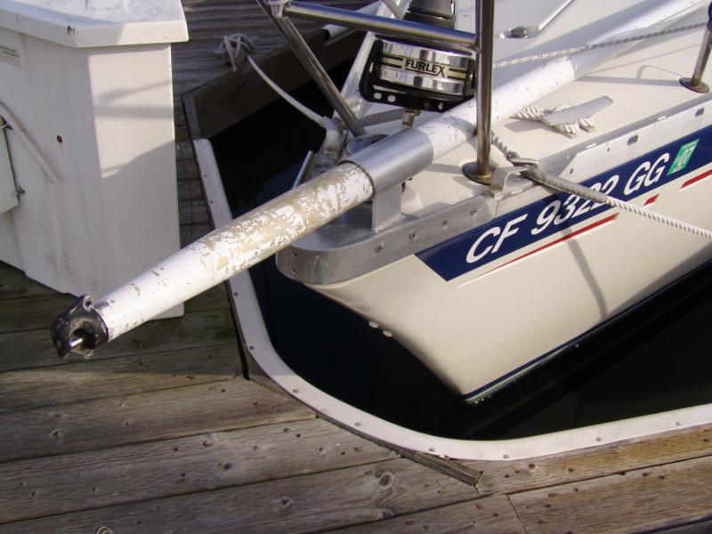

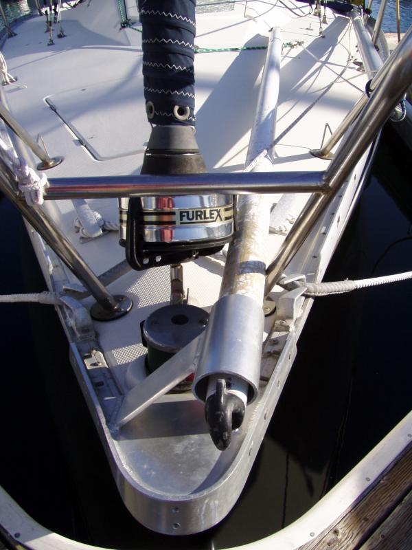

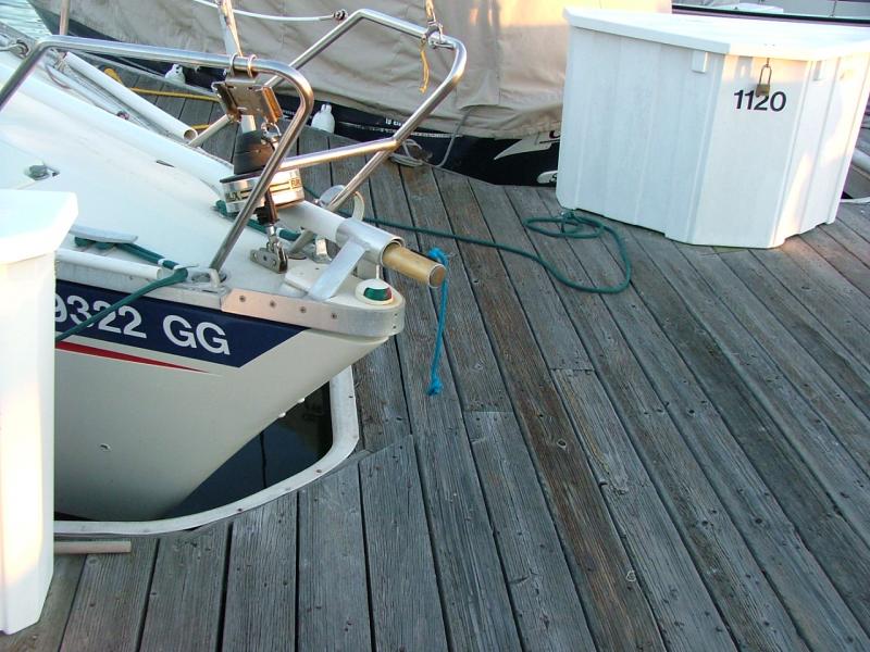

Here are the pics of the retractable bowsprit. It keeps me off the bow. I retrieve the chute in a sail bin I mount above the sink. The black line extends the sprit. The blue line is the sail tack,and is also used to retract the sprit. The standard pole is stowed along side, the ring stops the pole from flopping around . the foredeck is rather busy.
As you can see the system is rather spindely and I only use it in light air.
I'm thinking it would fold if things got serious. As most of my racing days are behind me I hope to be wise and reduce sail area BEFORE it gets that serious.
In heavy air I'd opt for the earlier version spin pole system. All this was fabricated out of marine savage parts other than the Fwd mount that was all custom Fabrication. I'm sure if you purchased specific tubing the system would be much stronger.
So there ya go..... thats how I dealt with the issue.
