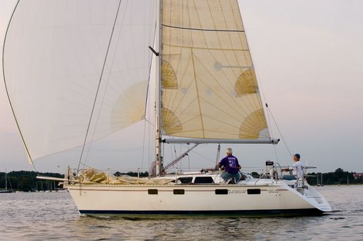

Here's a picture of a 356 that is on this forum (blue, yellow & white spinnaker). The other is a pic of my 35.5 with an akite and a sprit I built for it.
You can fly an akite from just about any boat, all you need are some rig dimensions.
For easy off wind sailing it's terrific! Go for it you'll love it. :D

I got an asym from Quantum that I like very much. They offer a range of styles: flatter (more reaching), fatter (more downwind), etc. I got a mid-range. Also got the furling sock. The only new pieces of hardware were two 3" Harken blocks for the sheets, attached to a ring on the arch, and a 2.5" or 3" Harken block that I attached to the anchor roller fitting for the downhaul. I lead the downhaul back to one of the cabin top winches. Come to think of it, I must have ordered a spin halyard when I got the boat, so if you didn't, I guess you'll need to add that, too. In any event, hoist the asym with the spin halyard, pull it down with the downhaul, sheet it with a sheet to the block at the stern, led to a jib winch for trimming. Pretty simple as these things go, and very effective, especially in light air broad reaching and running. I like it quite a bit. Two people can fly it, I suspect I could fly it myself in lighter air if motivated. This is on an H356, so would be virtually the same for a 36. Glad to talk further.

HI Deac! Alan's posted a picture of Escape above, and Paul's almost exactly described our rigging-the only difference is we used a set of reefing line blocks to bring the guy (downhaul for the tack) back to a turning block on the arch and then forward to a jam cleat on the side of the cockpit (just like the jib furling line). That's a Doyle APC, I highly recommend them. We love flying the chute. As an alternative, look at a Doyle UPS-cut flatter, more like a code zero. The APC works well with wind angles from 90-180, while the APC can be used on a close reach in light air down to about 150 degrees. Be sure to talk to the sailmaker about your plans and check details. I've seen chutes from 850 to 1050 square feet (guess which I've got) offered for the 356 and it's a big difference
