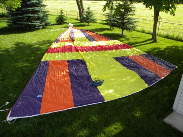

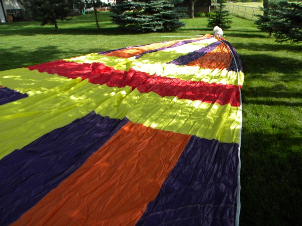

Yes I'm going symmetric, and an old one. The lower panels are not clew radial. I've seen older kites like that, but never asyms.
32
Beneteau FIRST 42 Coos Bay, Oregon
if its SYM, both sides are created equal.. that kite dosent look equal
Nov 8, 2010
11,386
I was thinking its just the way its laying there. The tapes are not exposed.... on port the tape is clearly rolled up, the lower purple panel is 1/3 covered by the time you get to the top of it.
And like I said I've never ever seen an asym that was not clew radial. The loads along the foot are much higher on an asym.
But who knows. Too bad clew and tack have the same number of letters in them! ;^)

The dimensions he supplied are 42'6" 37' 23'2" which would be Asymmetrical but it is not radial in design. He also says its only been up 4 times. I'm a bit skeptical.

Well if that's right its an asym for sure, construction methods be damned. Should fit OK, foot a touch long but luff is spot on.

It's old for sure. Over time spinnakers of all types have less and less purely horizontal or vertical panels.... they are now all aligned to the loads from the clews, tack, and head. Google 'Asymmetrical spinnaker' images and you'll have a hard time finding one that looks like that. But for cruising that probably OK, and if its only been used a few times its probably in good shape.
Only down side is that asym cut and design (shape) has come a long way in the last 5 years. They fly better generally, and most APs will reach and go deep well. Personally I'd offer 500. The sock is worth 250 if its good (but those have gotten better over time too) so that helps balance it out. But finding a used asym for a boat is hard. That one is almost spot on.

Yes, it is an asymmetric spinnaker and this was a very common way to build them back in the 80's. Cost effective with the vertical foot panels, and as they don't really reach 'hard', this cut was adequate. I would guess it to be pretty old, but if not used much still serviceable.
A 352 asym should be in the 41-43' range on the luff, 37-40' on the leech and 19-22' on the foot for best use.

Are the pictures shown an Asym or Sym Chute.
It looks like a Sym chute by the way it's cut?
I'm interested in buying but only if it's Asym.
What do you guys think?
