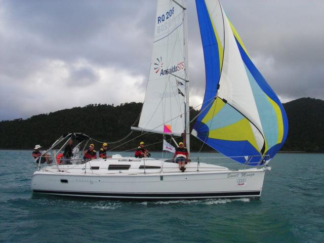

Has anyone here added an asymmetric spinnaker to their (2004-present) Hunter 33. If so where did you attach the turning block for the tack line? Do you use a tacker to hold the tack to the forestay/furled head sail?
On the H33 there is a hole on the port side of the Stem Piece. Put a shackle and turning block there. For running let the tack fly up around 1 metre above the block. (not as in the photo ,we have learned a bit since then!) Also I have found for best performance dead downwind when racing is to fly three sails with the spinnaker and the jib poled out on the other side. The boom brake is very useful for peace of mind..The tacker can be usful if you want to keep the spinnaker up when reaching. I found that you can almost use it as a big genoa. This is a big help in light winds as the small H33 headsail doesn't develop enough power.
I am thinking about asking Father Christmas for the Selden sprit kit as I reckon that would even add more power.

Nick, I just got a Asym and plan on trying it as soon as our season starts. Could you post a picture of how you have yours rigged at the stem piece?

After looking at your picture I realize there are no telltales on your genoa. How do you trim that sail without them?
Also the combination of the main and genoa block most of the breeze from the spinnaker. You will find that DDW is the slowest point of sail. Reaching up slightly and removing the genoa with produce a much better VMG.
