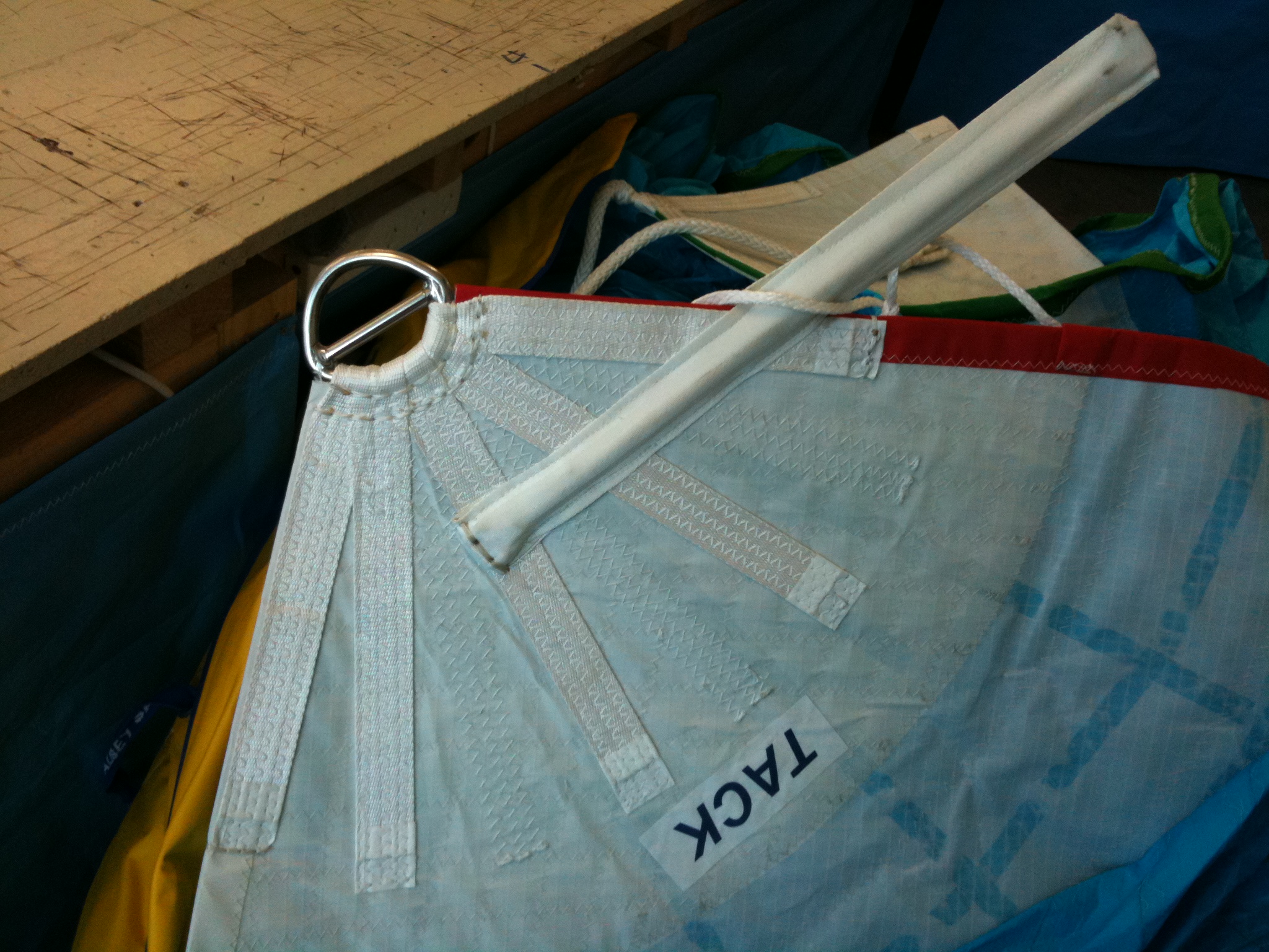

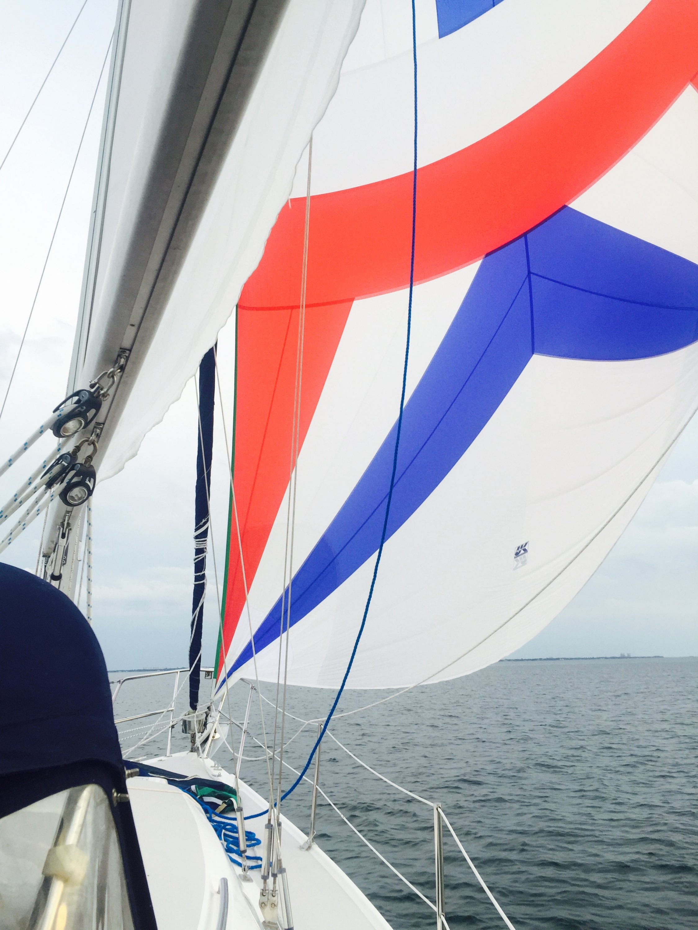

OK because people have asked again.... a gybulator is a small wand attached near the tack of your asym. angled upward, it holds the lazy sheet and prevents it from falling into the water and under the boat. Most sailmakers can add them for less than 100 bucks.
in action
