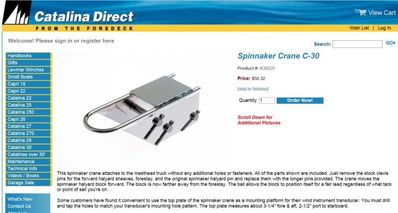

I have heard of some using the mast head crane Catalina Direct offers but, I'm not convinced there is not a more elegant solution.

If you feel the existing hole on the masthead won't give you enough clearance, you can purchase a masthead "crane" ... a piece that fits easily over the masthead extending the spin halyard block well forward of the furler's swivel. I think www.catalinadirect.com may sell the crane....
Rigrite http://www.rigrite.com/Spars/SparParts/MH_Spinnaker_bails.html calls the "spinnaker bails"... but they're the same thing.

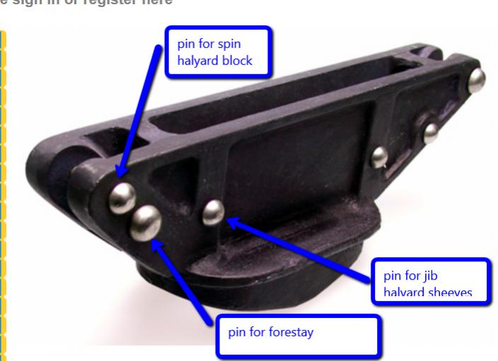

I attached a 30-13 Garhauer single block to the forward most pin on the masthead truck see photo 1 & 2. This puts the spinnaker in front of the forestay where it belongs. You can also use the spinnaker crane available from Catalina Direct. See third photo.
The spinnaker halyard will always cross over the forestay on one tack or the other and this will cause a bit of chafe. I just keep an eye on it and when it starts to show wear, I just cut it off at the chafe and redo the eye spice. It usually lasts a couple of seasons of club racing.
You can run the halyard internal if you like but you need to have it exit the mast about 4’ from the top so that it will have a fairlead to the block in fount of the forestay.

I think you're over thinking this.... Just rig it the way Hayden Watson explained, I recommend spending the $50 on the masthead crane.... that device will keep the halyard block way clear of the headstay swivel. As he explained, you can monitor chafe at the shackle end of the halyard when you use it.... cut it off and splice a new eye when you think it's a problem. Just add a few feet to your halyard when you purhchase.
