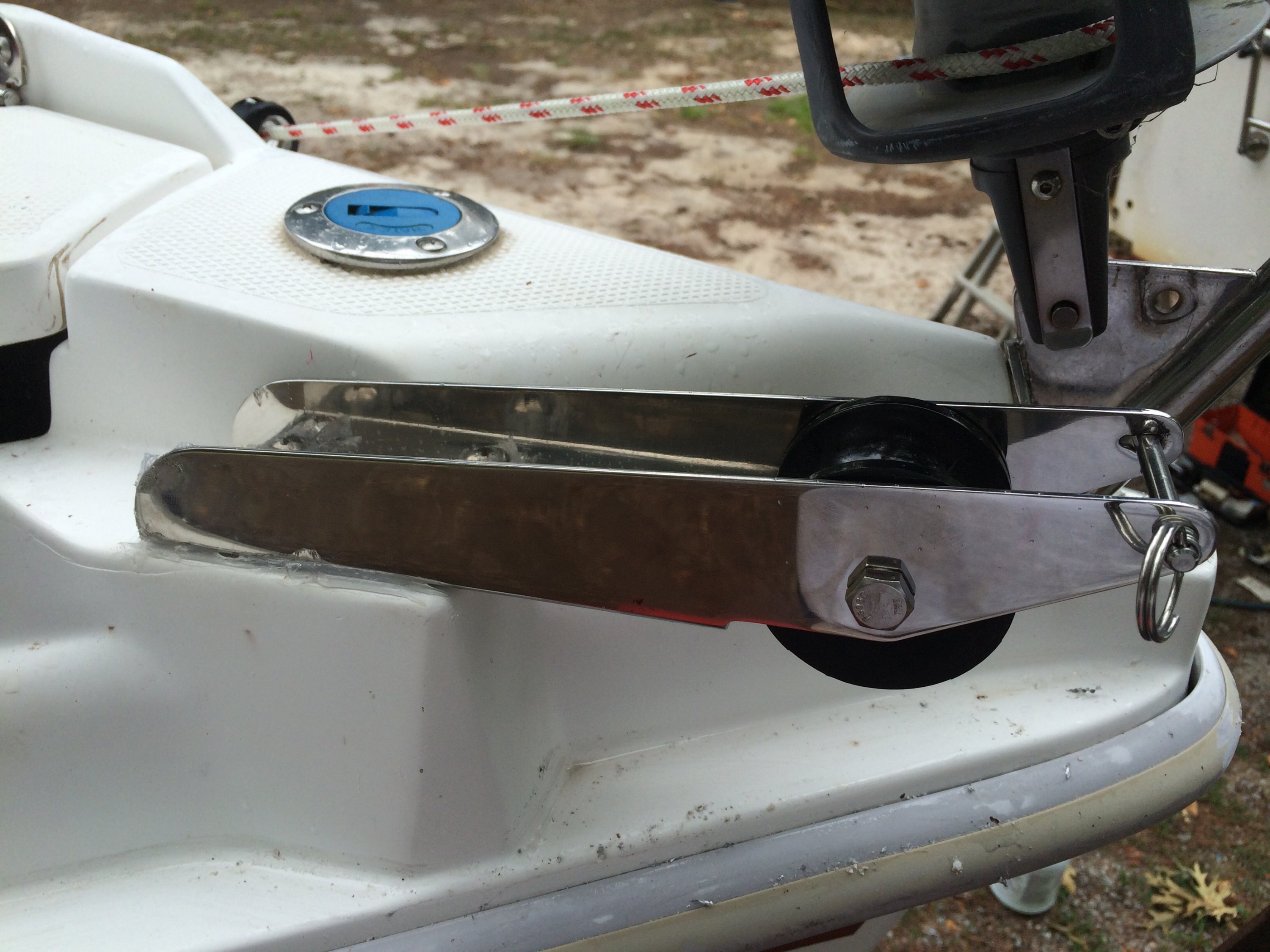

Never thought about using my brand spanking shiny new bow roller. Do I attach the block to the spring-loaded slider-over bar?

The j105 has an very large asym. Having the pole helps it get out of the shadow of the main and also enables you the crew to do "inside" jibes more easily.
If you use your anchor roller as a tack attachment point, you really need to make sure that it can take the load.
I would be very hesitant to use it on a roller like in Kermit's picture. It's going to be one big lever arm and pull right up!
Also, I would not use it without having the main up even though it seems simpler. If the wind picks up and you have to douse it quickly, it is easy to head downwind and luff it behind the the main to depower it.

I would not recommend using the anchor roller pictured. As mentioned, it looks like the tack roller would be too far away from the mounting bolts. On my Newport the last bolt was only about 6" back.

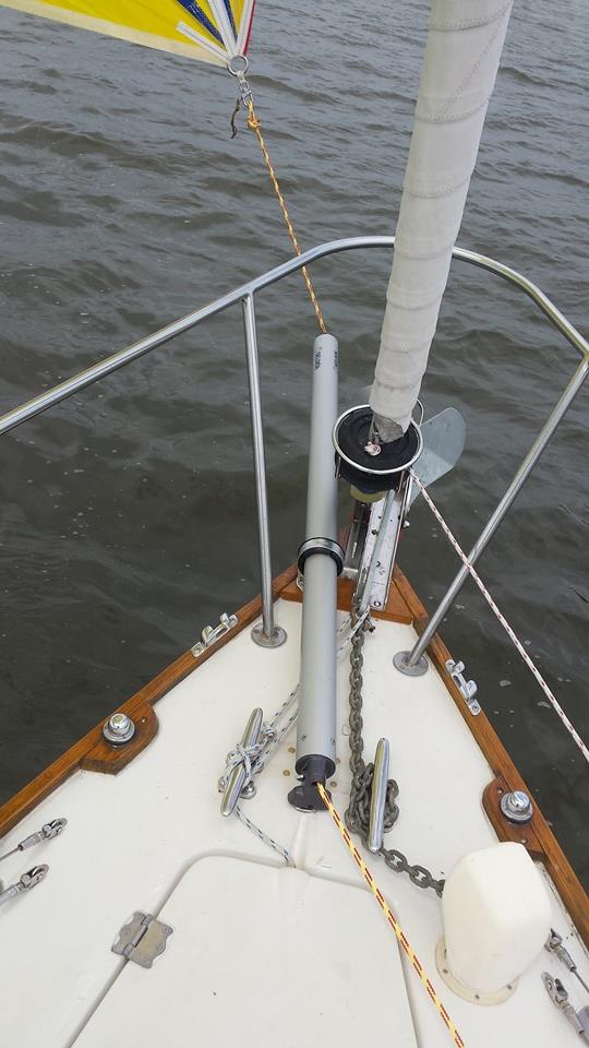

My spinnaker is undersized since it was built for my H23. Didn't include it in the sale so I could keep on flying it on my H260. So far I've flown it twice with a double block that I put together between the pulpit. I'll try to get good pictures next time I fly it. Crazy Dave has seen my system in person and thinks it's ok but not great.

The other problem I see with using your anchor roller is its position. The Asym would be right next to the furled genny and not in front of it. Frankly, I don't think that will work.

Not to worry, dhays. I'm gonna keep flying it as is and will post pictures when I can get some. Thanks!

Kermit,perhaps you could attach the tack to the hole just forward of where the furler is mounted. The two fingers of your bow roller seems prone to bending and the spring loaded pin may get dislodged.

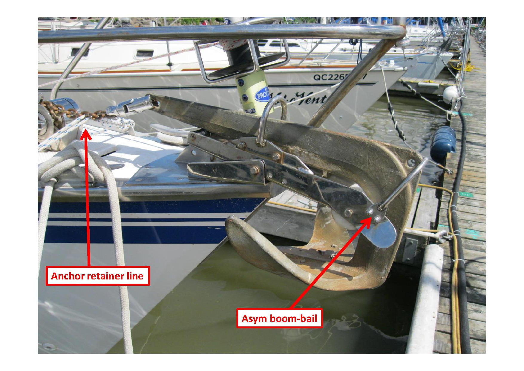

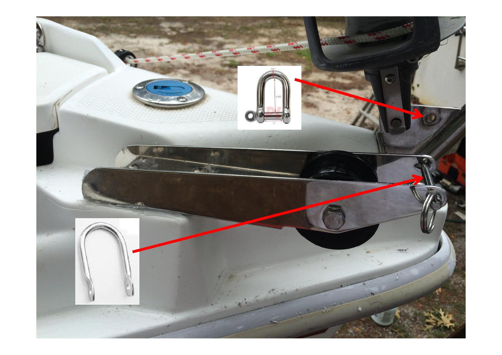

Kermit,
If you're confident the anchor roller is solid enough, you could use a boom bail instead of your spring-loaded pin. Then use a short line to secure your anchor.
If you want a stronger attachment point, install a D-type shackle in the forward hole of your head-stay attachment. Put a sheave on that shackle and you should be good-to-go.
Look at attached pictures to view the options mentioned and the anchor attachment line.

Dang, Claude! Thanks for taking the time to not only explain this but to create illustrations. This is EXACTLY what I needed.
I don't know if markwbird is ok with the thread drift here but please know that I have learned alot from it. I still plan to use what I have and will post pictures the next time I fly my spinnaker. I don't fly it often, though. And it's always stressful. But dang I love flying it.

On almost any sized boat, I would be wary of flying an asym tacked to any spot not designed for that purpose. In particular, bow rollers. If you bow roller has more length extended that it has bolted to the deck, you're asking for trouble. That means you Kermit! The only way to address this is to use a bob-stay to the bowstem to take the extra load. Many new boat with bow rollers designed as asym tack points have hard bobstays built in.
You might be ok in less then say 8 knots but into the teens and you start tearing stuff off. This include bow pulpits.
