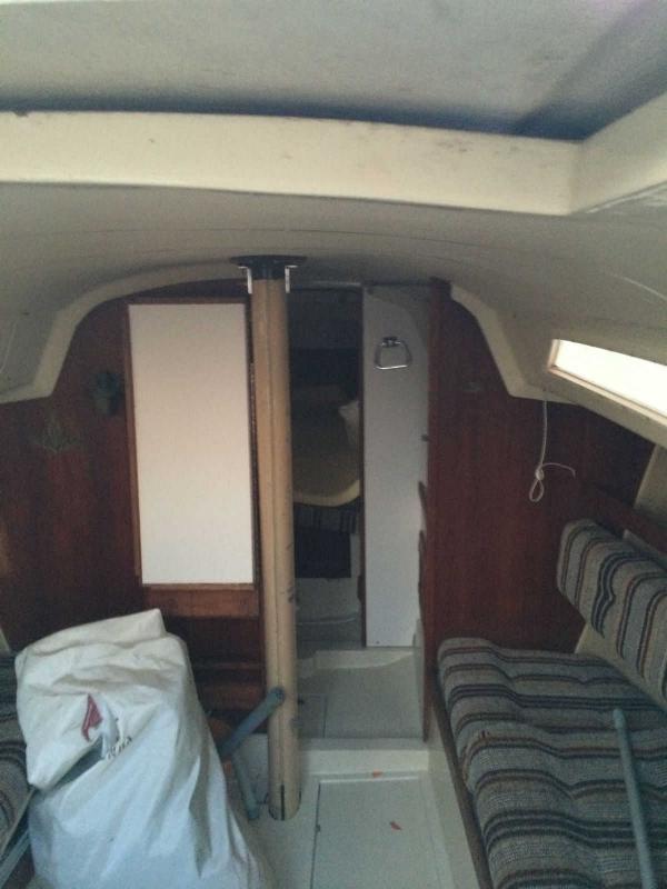

What you refer to sounds like the mast support to take the weight and pressure of a "deck stepped" spar. i.e. one that is stepped on your cabin top. That pole is required to transfer the force of the spar down to the keel (or some support structure on top of the keel attachment to the bilge).
Edit: OOPS.... just noticed that the 'OP' posted once in 2014, and never returned! All of our pontificating is going unnoticed......
No Worries is a keel-stepped mast. I also have what appears to be a support for a table. The pole in question is just forward of the hatch opening. It actually works well for a center handhold, No worries came without a table. The mast is directly aft of the salon bulkhead.
