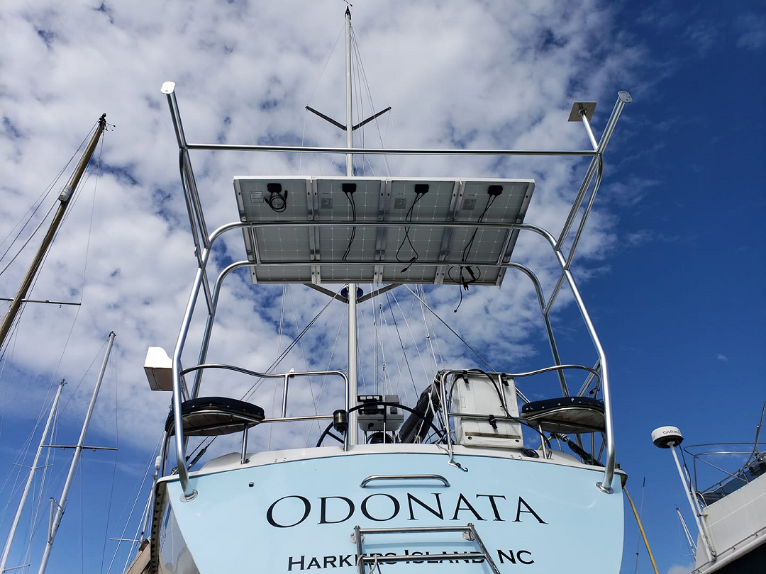

Hunter 37 Jacksonville
I don't remember exactly the dollars, but think it was around 1200 - 1400. No pics at home. But it is exactly like the one above on a Hunter 46.
