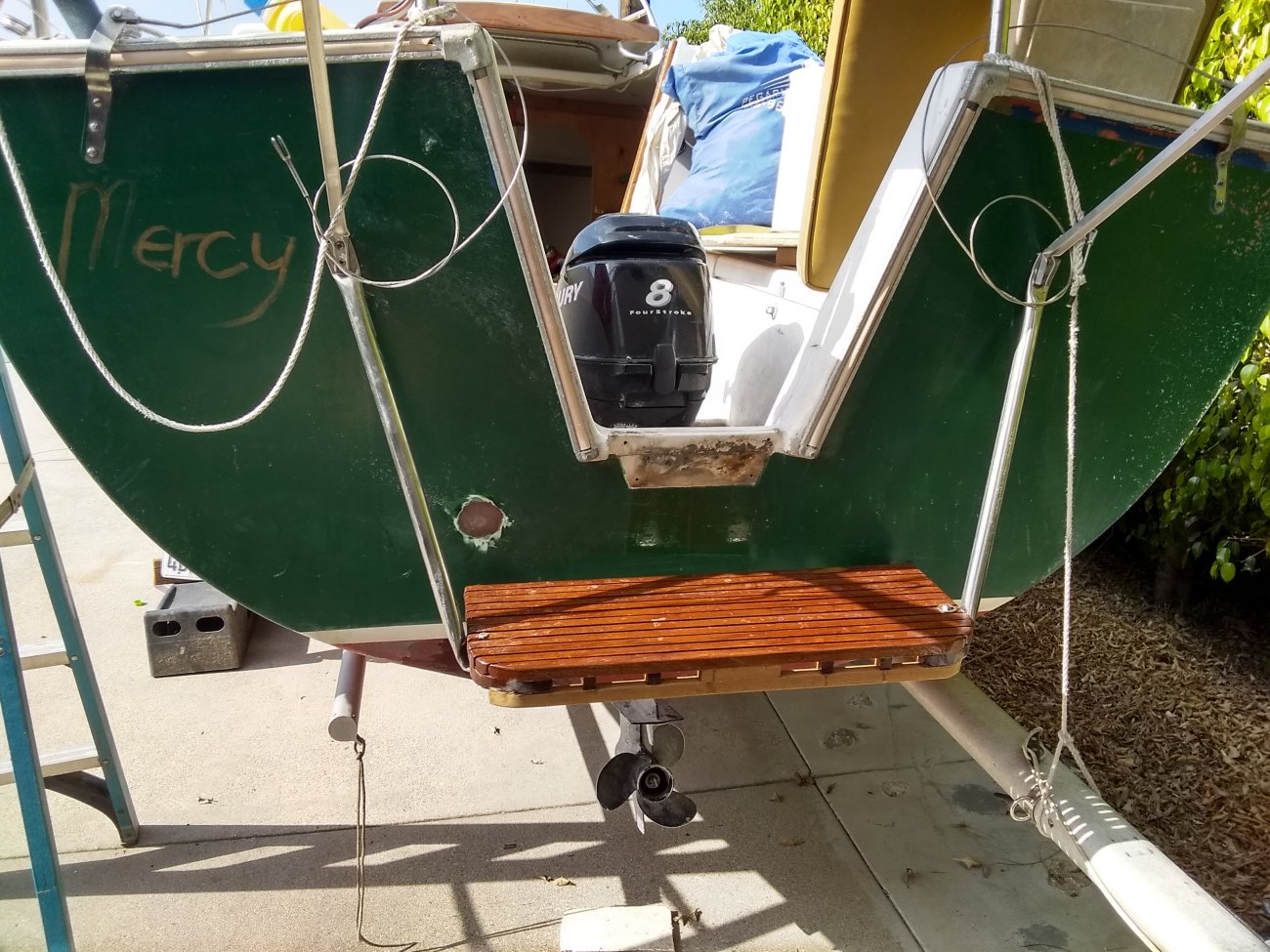

I like the boat but the rudder engine set up is insane. The designer put the prop behind the rudder!! Putting the bow through the eye of the wind in a narrow space with only a couple of knots of head way is next to impossible. A 14 inch keel draft but the NON COLLAPSIBLE rudder draws bout 2.5 feet! And what do you do with the rudder/cassette block when lifted? It takes up the whole cockpit and leaves a huge hole in the cockpit sole. Im building a well in the cockpit for the engine and mounting a swing outboard rudder. Plus...the high topsides makes it impossible to get back aboard so the "V" in the transom for the current engine place will be an excellent boarding space.
