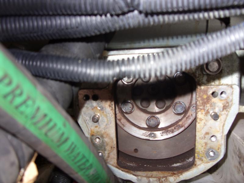

Witz, I replaced the r&d with a Sachs damper plate that has springs. I also made it to my boat and I have the motor mounts like paulj has.
Boy I'm confused, wouldn't be the first time.
The holes on the mounting plate are completely different as well as the diameter is much smaller. Did you use a different
Sachs other than the #1866--50-002?
Sep 29, 2008
1,980
Catalina 310 #185 Quantico
Sachs other than the #1866--50-002? /quote]
Witz, I used a Sachs Damper Plate #10 1866 061 001. Bolt holes lined up perfectly. ;)

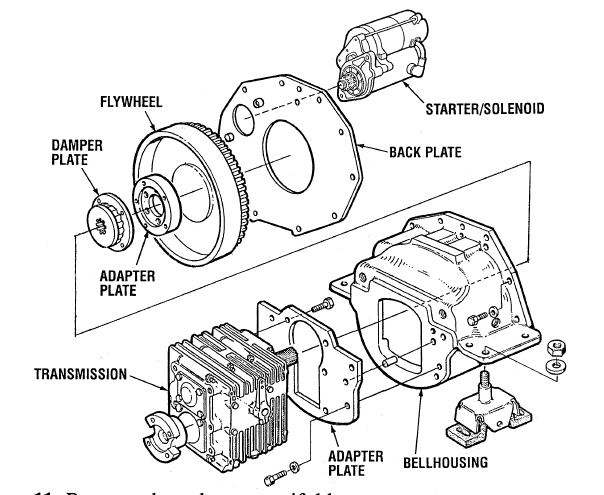

RP, not sure what the torque specifications for that plat is, but below is a excerpt from the discussion concerning my replacement. Maine confirmed the proper Sachs part # of 1866-050-02. The entire thread can be found at:
http://forums.catalina.sailboatowners.com/showthread.php?t=113844&highlight=damper
Maine Sail 11-17-2009 03:15 pm Witz,
I just made a call to the distributor who ships the engines to Catalina and whom I get my Universal/Westerbeke parts through.
The R&D damper plate was stock, and factory, however according to the distributor "We had nothing but problems with them and most of them failed and some caused more damage than good"
I never knew Universal used anything but Sachs but apparently they did try some R&D's...
The spline fit was most likely spot on but as it failed it began to eat at the splines. The replacement Universal/Sachs damper plate is a Universal part number U-299156. I had them pull it off the shelf and read me the part numbers. The Sachs number is a 1866-050-002."
Ray, my point here is that you may be experiencing increased vibration due to a plate that is too stiff. It is the damper plate's function to smooth out rotational vibration that is present in light fly wheel low cylinder count engines like ours.

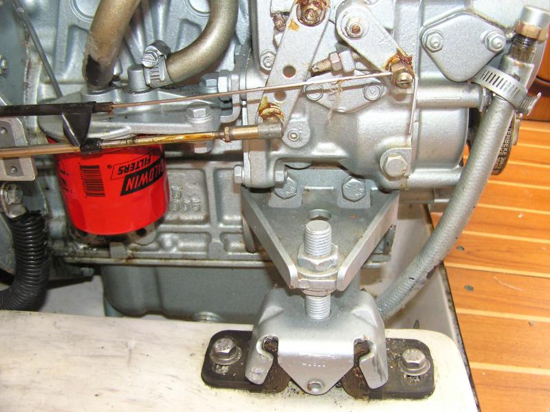

Witz, the part I used was recommended by the distributor in Seattle (MER). It fit and he did state it would be a bit rougher and noisier. I do like your idea of a block under the motor mounts to raise them up. What thickness did you use? I have some extra pvc board that might work (3/4" thick).
Dec 25, 2008
1,580
catalina 310 Elk River
Depends on how much you have the adjustment raised up to get your alignment in. I used 3/4" marine plywood on the front ones.
