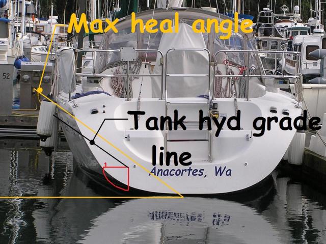

Had a nasty mess to clean up this last weekend. We knew the tank was getting full, but went sailing anyway. 15 knots had us heeling at 20 degrees and more. Head overflowed by virtue of the holding tank contents...
Anyway - I went to the head mistress expert forum, and saw repeatedly her recommendation to put loops above the water line to prevent water (and other stuff) from seeking their natural level...
The water inlet appears to have a vented loop on my 310, BUT the outlet hose just goes gradually up to the tank. Anyone tackle this addition? Any advice?
For now, it just looks like a dirty job that someone has to tackle...

I think you should give Peggie a discription of your system and your problem and rethink the vent hose.
joker valve.................

The new Jabsco head pump has a feature that seats the discharge piston. You dont need to worry about slow (or fast) backwash from the holding tank. Its almost cheaper to put in a new one than rebuild the old anyway.
I dont think your vented loop on the discharge is a good idea.... if it ever leaks/clogs... oh my!!!

Wasn't thinking VENTED loop. Just a hose loop higher than the inlet to the tank, per some of Peggy's responses on her forum. I AM seriously thinking about replacing the head itself. I also think the wet/dry lever wasn't fully clicked to the DRY setting, and it doesn't positively CLICK into that setting anyway...
