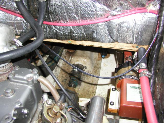

Still wondering what your water lift muffler installation looks like,
I'm not sure what kind of muffler I have but it looks like a small shop vac. Maybe an earlier Vertus or similar waterlift. The exhaust line runs about horizontal and slightly downwards. The base of the muffler is about 6 inches above the shaft line near the coupling. Exhaust hose runs out of the top of the muffler, up into the cockpit coaming, and out the transom. The hoses are bent to the max but there weren't good options in the small engine space.
