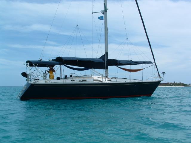

We rig the hammock between the mast and the outboard end of the spinnaker pole. You can set it up to whatever angle suits you for reading, sleeping, or sunning, and you can guy it off p/s more or less, as you wish, to benefit from the breeze or to adjust for sun glare or the view.

We use our whisker pole to support one end of the hammock and attach the other end to the mast/whisker pole attachment. Works great. Adjust the angle to suit your needs. Safe and robust. No fear of something giving way.

I led my spinny halyard forward, wrapped it around the furled sail, and attached a hammock to that, other end to the pole attachment on the mast. Seemed OK. I like a beanbag chair, too. Take out about 1/4 of the beans, makes it more shapeable.
Sep 20, 2006
2,952
Spinnaker halyard, does get a little sea sick if you're below....
and this is what happens when Dad is at the spin halyard clutch....
