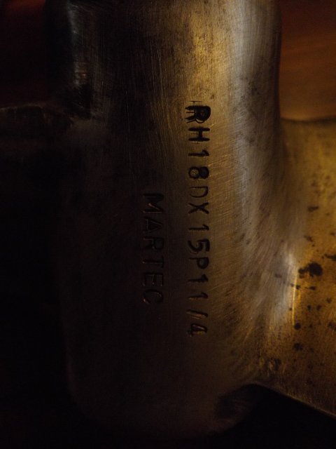

The markings on the remaining section of prop are
Martec RH18DX15P11/4
Whilst its a long shot - if by chance anyone has a spare one (perhaps you upgraded to a folding) they are willing to sell I would love to hear about it.

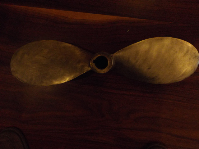

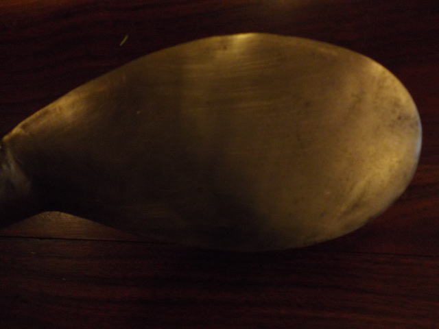

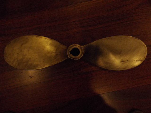

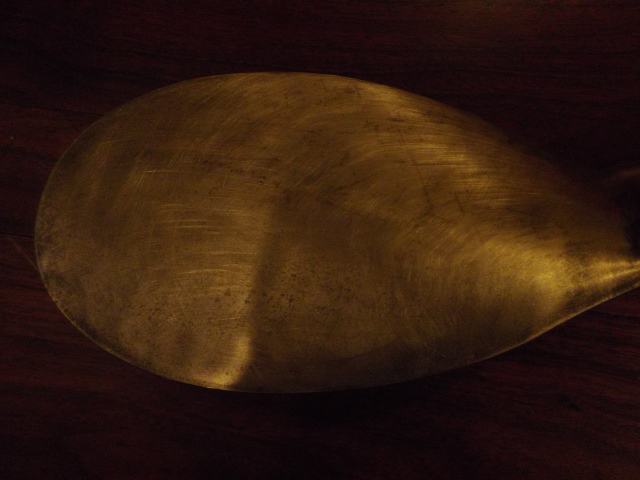

Here are some pictures of the one I have. I sent you a pm.

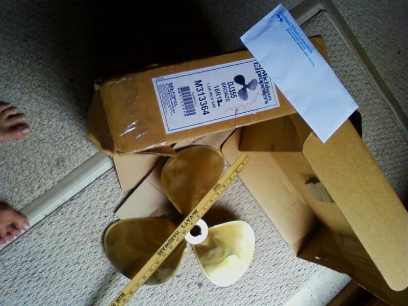

I might be able to get a 3 blade - not sure on exact specs yet though or price. Would the pitch need to change moving from 2 to 3? I was going to put a call into martec on Monday and fire over these questions but would appreciate any and all advice.
I'm already hurting on the strut replacement + haulout (which now includes a bottom painting!) so not sure if folding is going to be possible - what are the benefits?
Will get on that link this afternoon - just sat on a plane right now waiting for takeoff!
Thanks again!

With a folder or featherer you will get materially improved light air performance and better pointing offset by some loss of backing thrust and maybe some added roughness. However, you are already spending a ton, and since the prop can be changed in the water another time, I don't think it's worth it now unless you find one used in good shape. A three blade will be sized differently from your two; Martek can provide the spec's.

From the markings - 1 1/4
