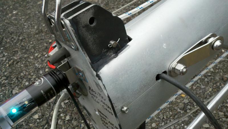

I did change my mainsail and jib halyards from wire to rope.
I pulled my wife up using the jib halyard last year. She then cut the mainsail halyard and ran new all rope line through. 3/8" was the largest I could use if I recall. The sheaves in the top mast were for wire, but they held the rope fine.
The following year, I took the mast down and replaced the jib halyards too. I also replaced all 4 sheaves with new onces from Catalina Direct...$56 a crack!
The only negative thing about the new sheaves was the hole was larger than the original pin...so they float a bit. But they work great.
On my setup, I couldn't replace the sheaves while the mast is up because you have to pull that 'pin' which releases either both fore sheaves or both aft sheaves. i included a picture of the masthead. The pin that is still in place is the one that holds the sheaves....
I would assume that if you're replacing the spreaders, then the mast is down and all of this will be a breeze.
