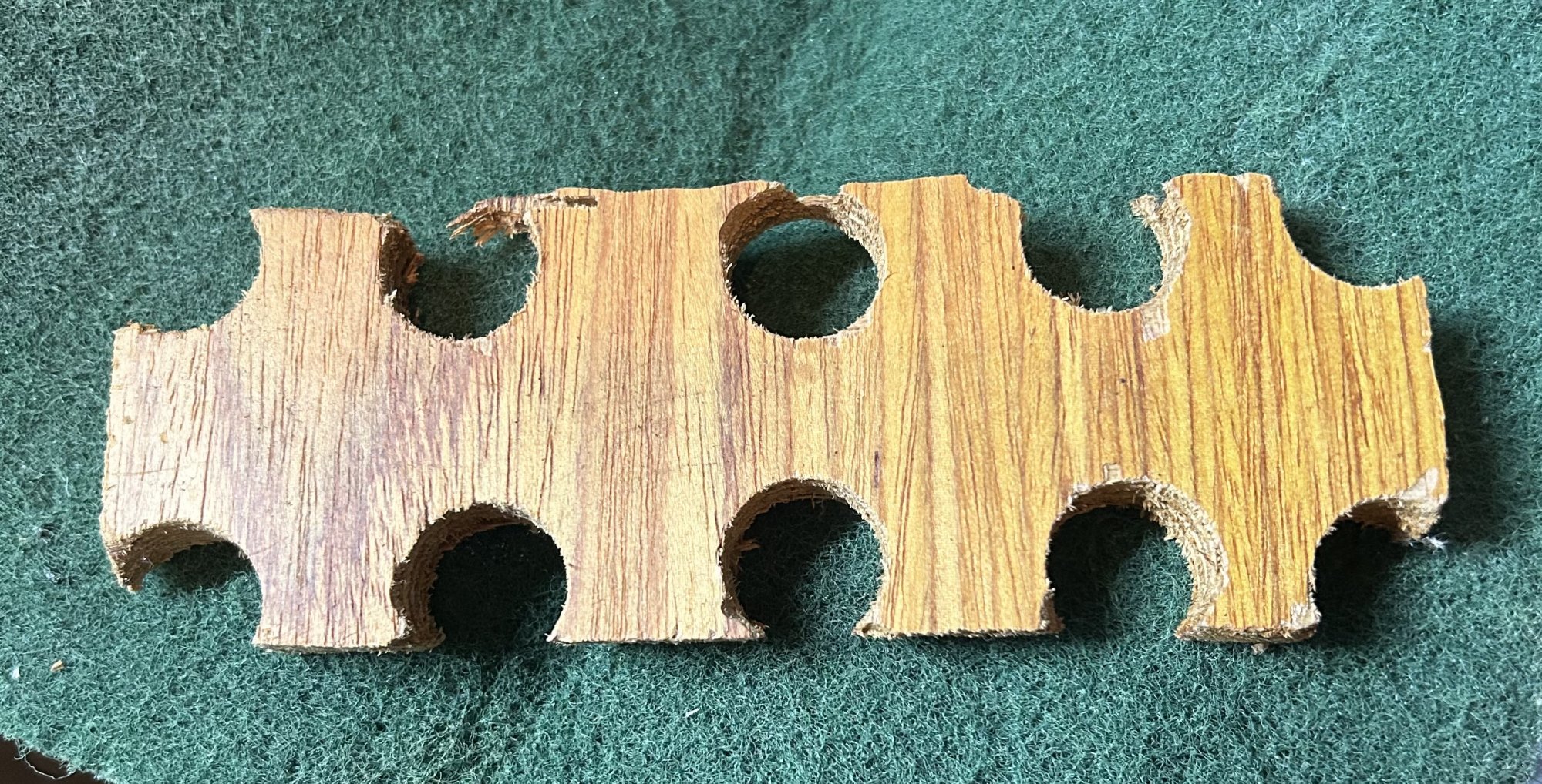

Keeping the sawdust from prior woodworking projects is a good practice to get into. More so in the boat world. Wood interiors cannot be matched and I would say anyone would be hard pressed to find a match, given the fact that all we have now is big box stores. When I cut out the opening in my boat to mount a new VHF radio I kept the piece. I just have to get to separating the veneer from the underlay plywood. I have two small holes to fill this winter.IMG_1920.jpeg

Yeah i know what you mean. My boat interior is entirely Burmese Teak. I accidentally threw away a very important trim piece/panel in the hallway and am now trying to find a nice piece of veneer to match.
