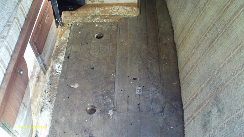

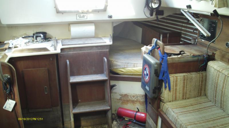

ive attached pics as well
I recently picked up an 82 h30. this is my first boat so im in need of suggestions. the boat was dry-docked 9 yrs ago and abandoned. it was winterized and in good condition when docked but a hatch was left un secured and the boat flooded with about 8in of water. so you can imagine what kind of renovations will be needed. I got the boat for almost nothing an im very excited about fixing her up. any suggestions about refurbishing teak, and holly, general clean up, electrical and plumbing maintainence, etc would be greatly appreciated!!!! please help
see attached pics
10,103
Cool ! The floor does not look de-laminated ..might be re-claimable... did the water get into the transmission and engine??
I note very nice wood slats on the hull side of the quarterberth .. I don't think that was original..

amazingly, the floor isn't delaminated and the wood seems in good shape. all in all she looks like she needs little more then a shitload of elbow grease and patience. my plan concerning the engine is to replace all fluids, filters, and batteries. (where r the batteries?>). i seem to have lost the motor pic. what about lubricating the tranny and shaft before initial start up. how do i check the integrity of the tranny and shaft

Jeff, welcome aboard. From your pictures, it looks do-able as long as the engine works.
Seems like you might want to start making a list. Included should be a list of websites and vendors for all of your systems.
Don't know what you know mechanically, although you did say this was your first boat, we still don't know how handy or knowledgeable you are. Like, "I know all about diesel engines since I was a farmer and know all about tractor engines, but this is my first boat." Understand?
Even engines have their own sub-systems: fuel, electrical, mechanical and plumbing for raw water.
So, good luck and start out step-by-step. We're all here to help.

Batteries should be behind the engine on a platform and in front of the fuel tank underneath the cockpit. There should be an access panel in the quarterberth. She should clean up nicely. Post more pictures! We like pictures. I'd like to see the engine and how the V berth looks up front. I love my79. You'll love the way she'll sail. Wonderful boat. You have Cherubini Hunter, so don't overlook that forum.

If you need to replace the flooring if your boat is like my 1982 H30 the flooring is spot glued to the fiberglass deck. Put it up use a little acetone to remove the glue and use vinyl (from Home Depot) flooring to replace the sections. Not as fancy as the wood but indestructible.
