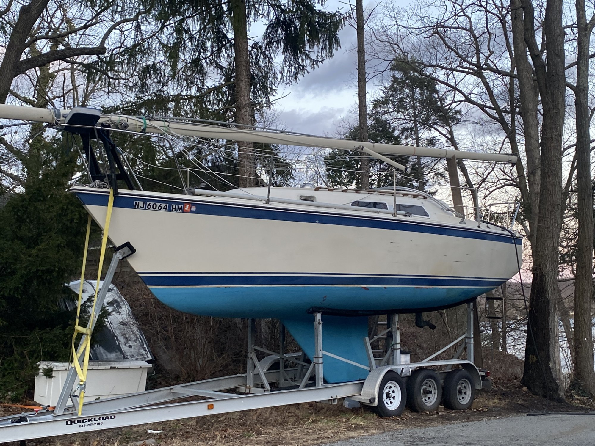

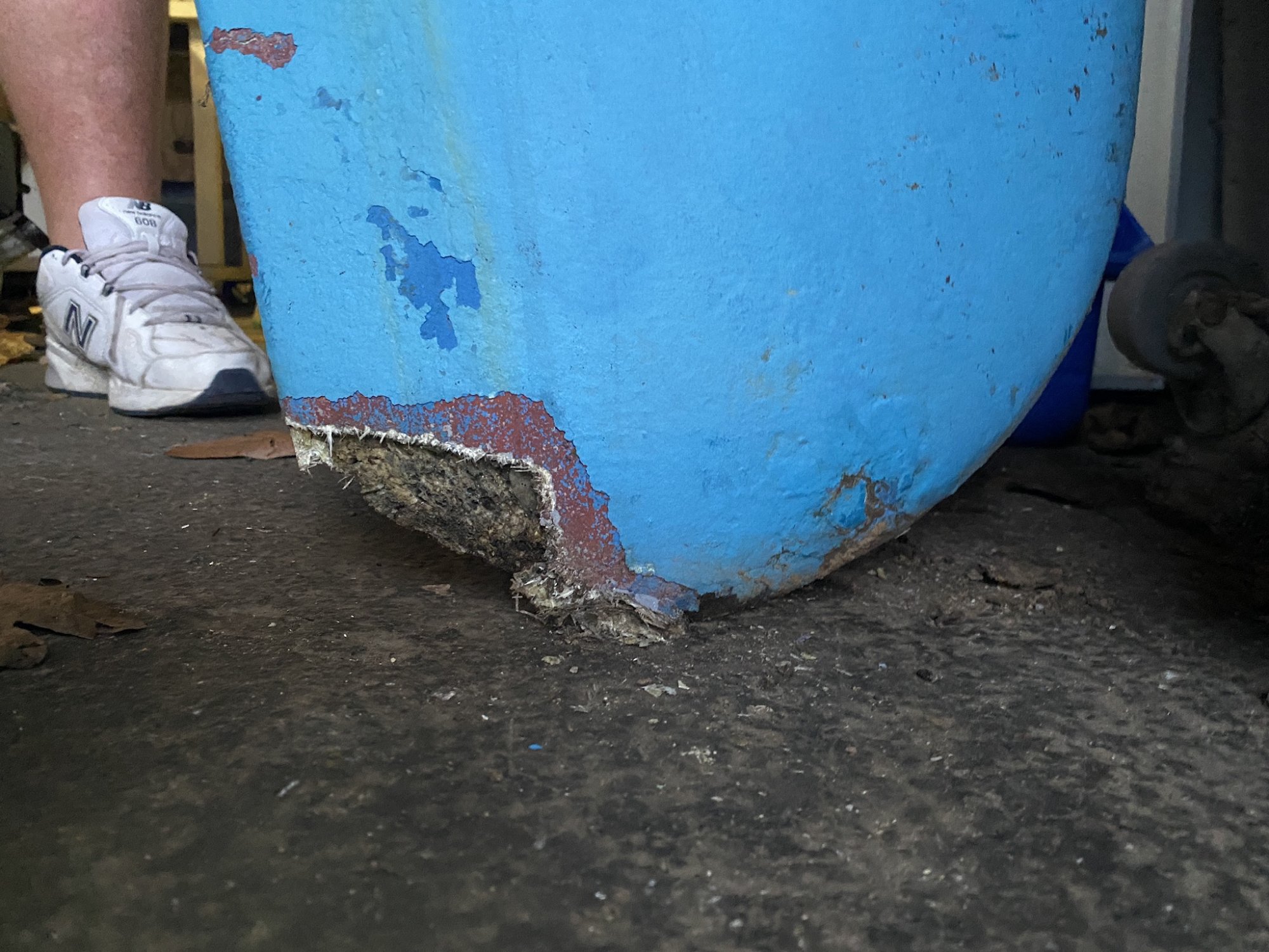

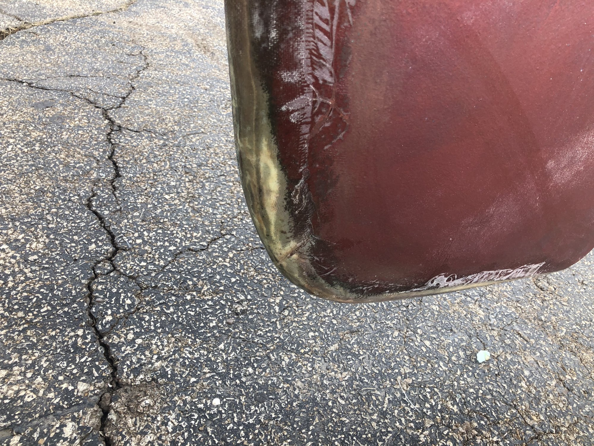

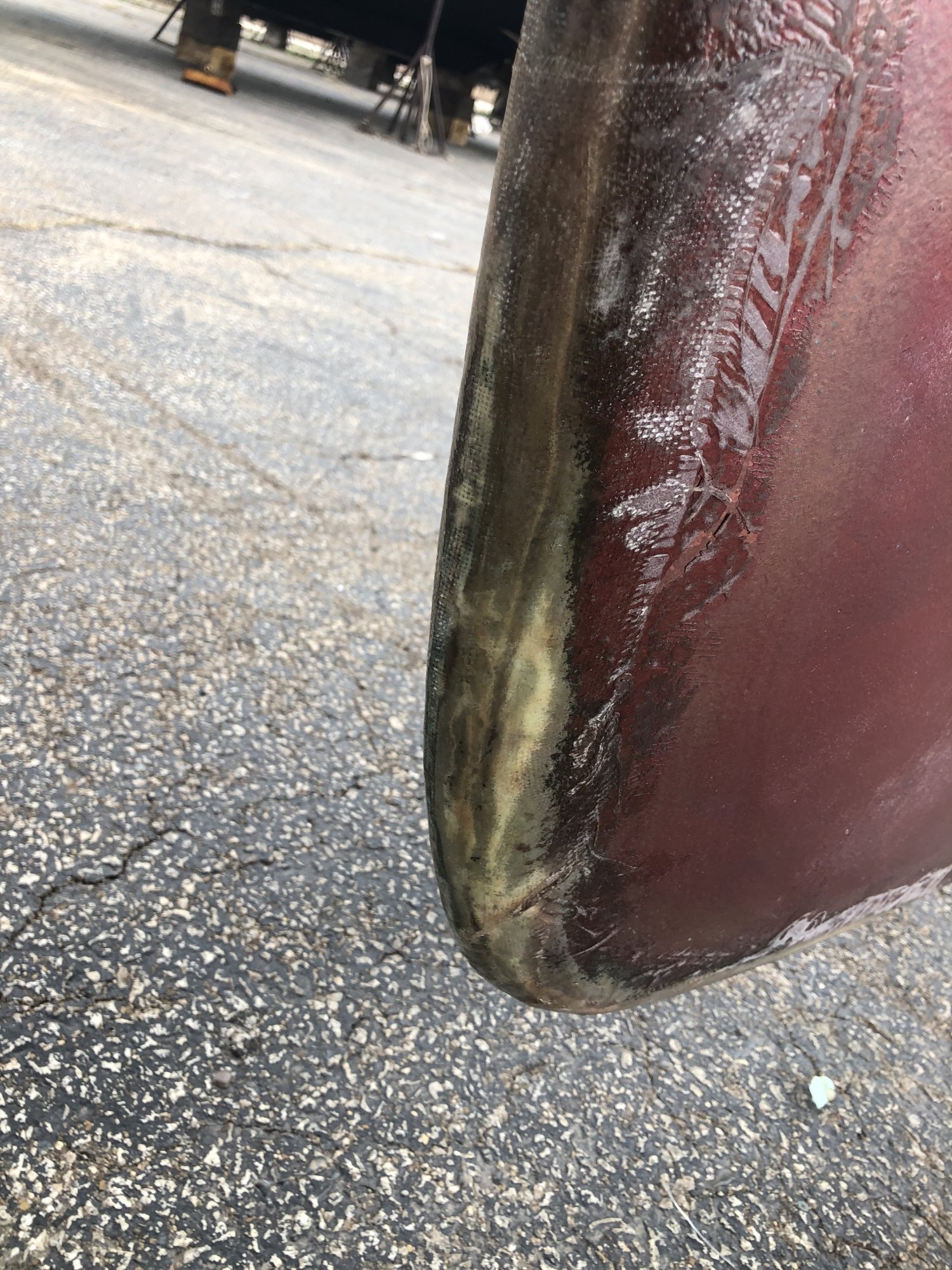

Any suggestions on how to fix this? Seen a bunch of YouTube videos, a bit nervous as to specifics. Appreciate any specific advice. 1980 o’day 28.

Looks like the rudder was dinged. Drain the water out. Dry the rudder. If all the damage is at the bottom of the rudder, then grind down to solid glass, fill the hole, patch and reshape using fiberglass epoxy. Paint and reinstall would be my go to plan. If the rudder has more serious issues, then you need to address those as well.
You can make this look good and serviceable. It may not look pristine new.

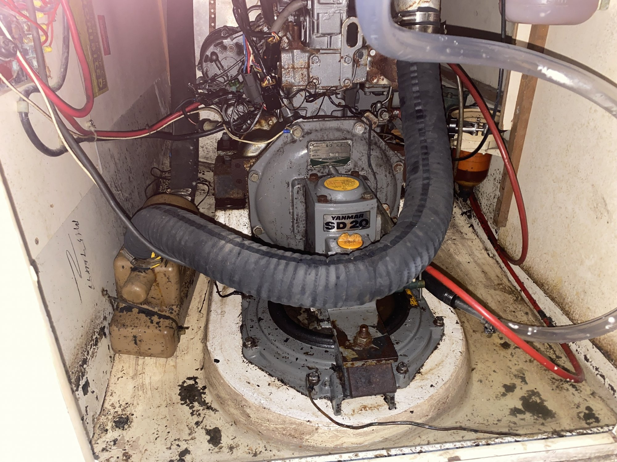

Thank you so much js, I was hoping that would be the suggestion. Rudder shaft appears to be nice and straight so I was hoping an inexpensive patch would work. I put deposit on boat and was hoping to get it in about 10 days or so. I forgot to ask previous owner how it happened, but will when I speak to hi again. It’s a 1980 o day 28 I got for $2000. Engine seems to run great, but sail drive ( SD 20 ) needs diaphragms replaced, easily accessed in this boat, but not sure if I should try and do myself. ( my first boat ). Appreciate any advice on both repairs.

New tools and skills are always nice to acquire. Just hoping I can avoid any major expenses. I’m expecting a fair amount to be sure, but boat was in real nice shape besides mentioned items. My biggest worry is working on that sail drive diaphragm. Not that many videos on this specific replacement. Some say not bad at all, others say the job Was a bit tough. But haven’t seen it done on this exact set up. At least it’s really accessible in this particular boat, I just feel everything is likely to be frozen in place from age. It was a fresh water boat, so maybe things will loosen up more easily.

You may want to contact Rudy at D & R Marine in Assonet, MA.. He may actually have a replacement. Costs nothing to call...
24,938
PB Blaster, Seafood, or Brake Fluid might work. Here is a video test of penetrating fluids.

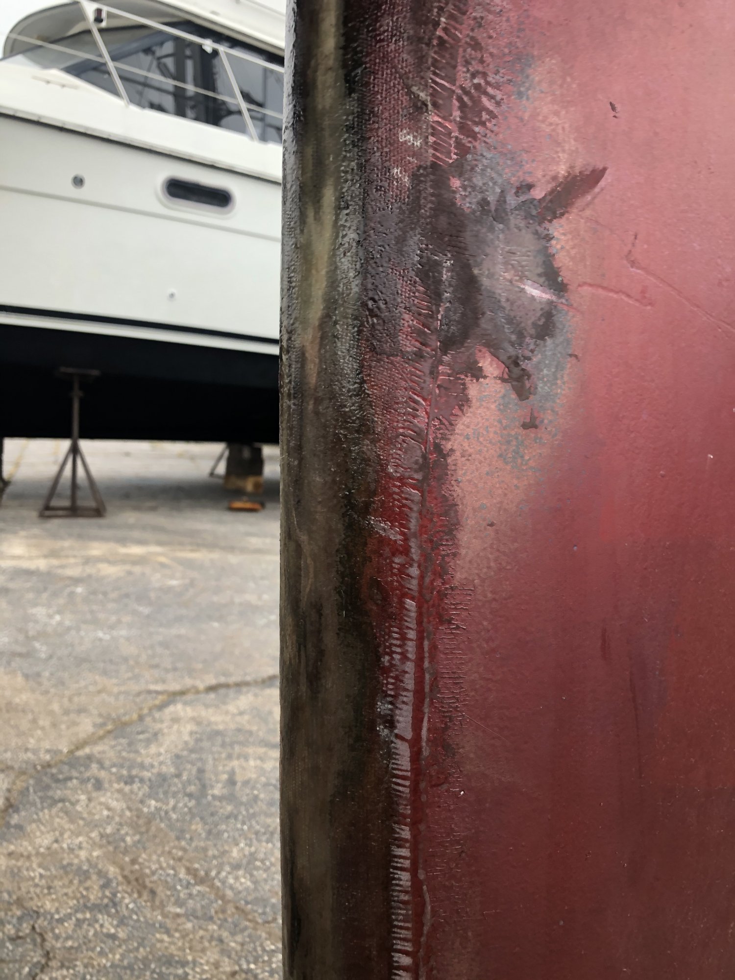

I agree with @jssailem....

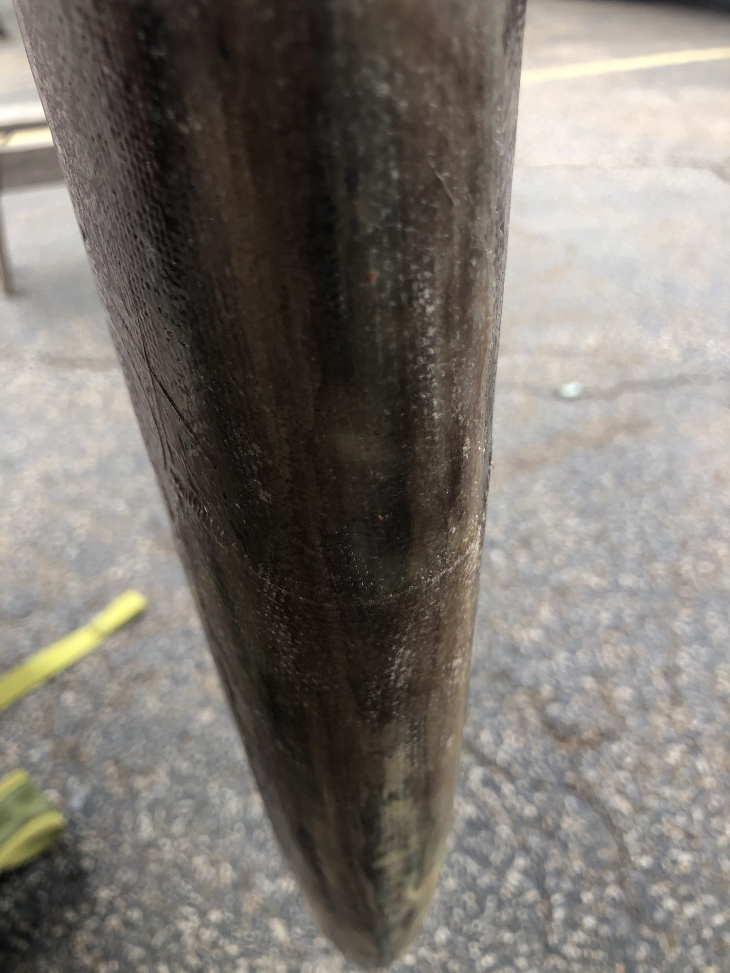

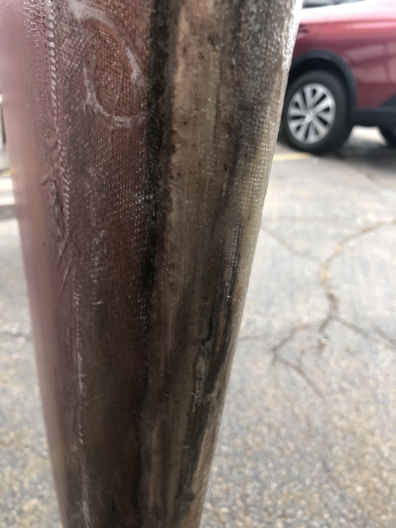

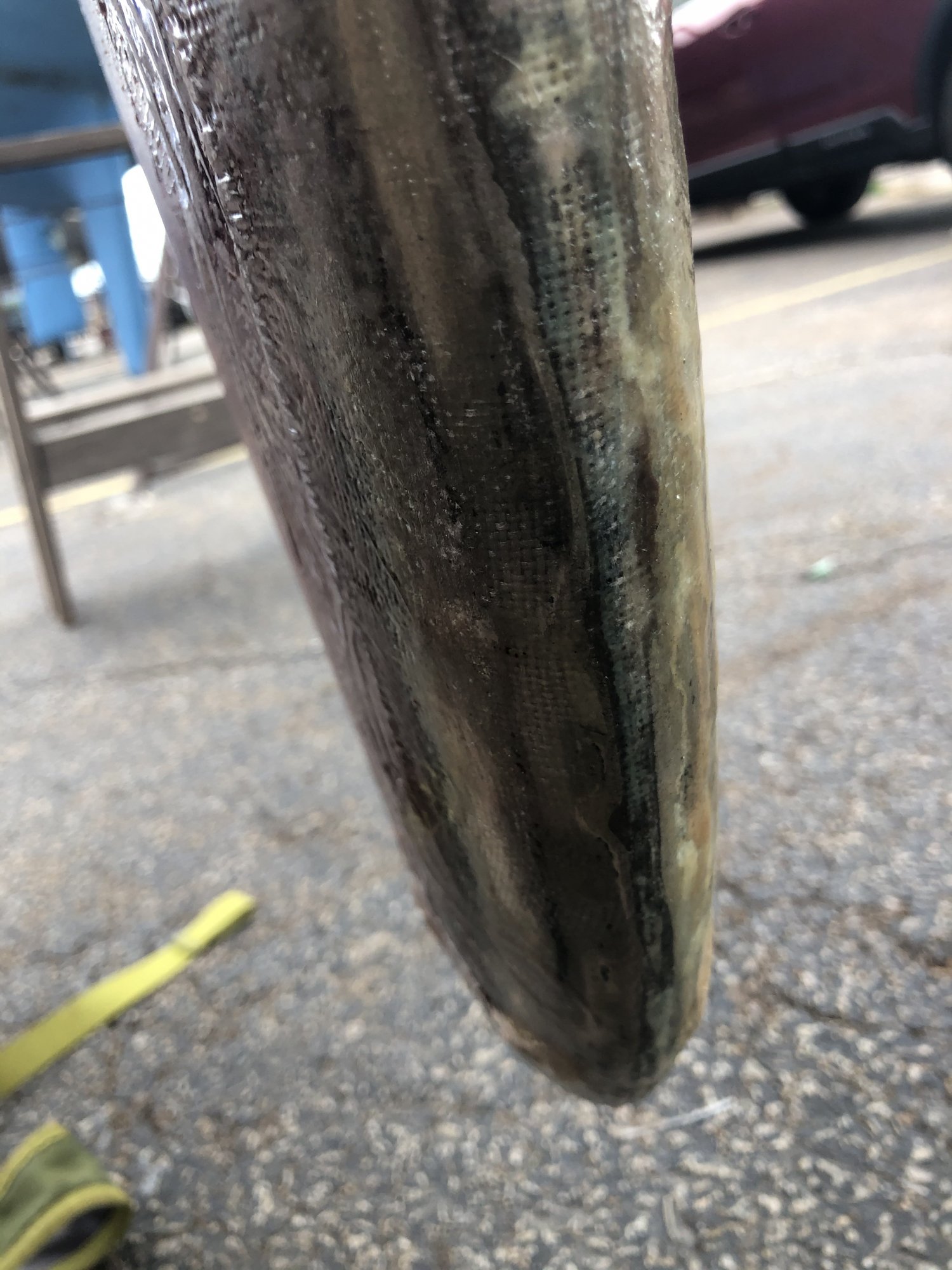

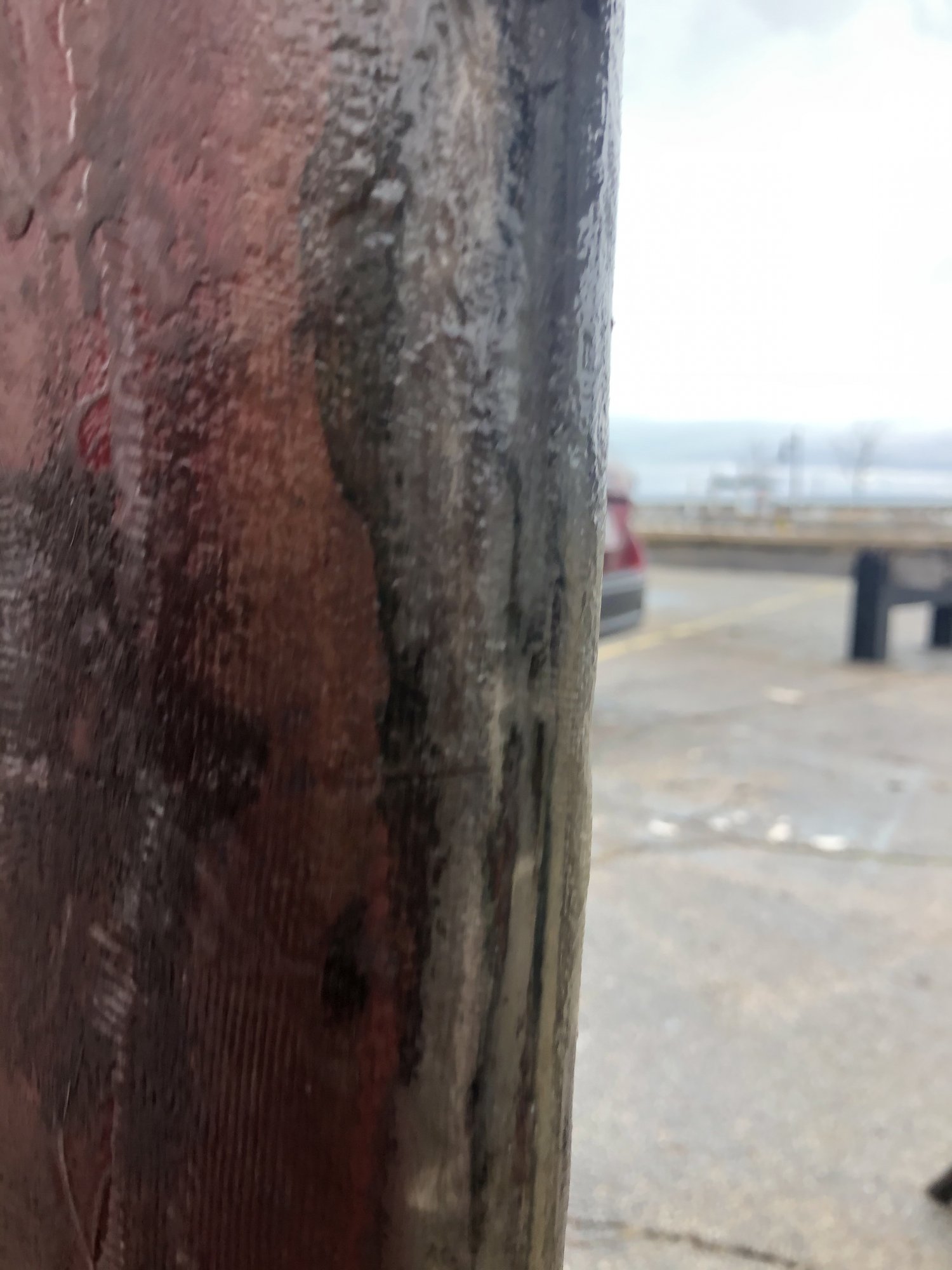

grind down that area and clean it up. Hard to tell how big of a chunk JS missing, but you need to fill that edge with something (wood, foam, etc.), the glass over it to make it all water tight and strong.
I noticed a few cracks in my rudder as I was checking it over before splashing in April. Not nearly as bad as yours, but something I wanted to fix before it got worse...
BD097537-628E-434A-8119-A41C166401C0.jpeg BED9D907-4626-406F-89B7-D651A5A2E3BC.jpeg 81BB0C5B-8A08-47A4-98B5-FBCB5EB0CF3B.jpeg B3F776A4-8C1E-4229-8104-5883019E0C67.jpeg 2AB350C5-B8A4-4E2A-A56F-6A83BD60F822.jpeg C9F3E24D-32C2-4AD3-994E-7EBE323EDC31.jpeg 8BDB29F3-7E8C-4590-994C-4AFAC18FC8F7.jpeg
I still need to sand this down, apply some barrier coat and then anti-fouling paint, it she should be ready to splash next week.
I have never applied fiberglass before, so this was a first for me, but I think I have the rudder sealed up.

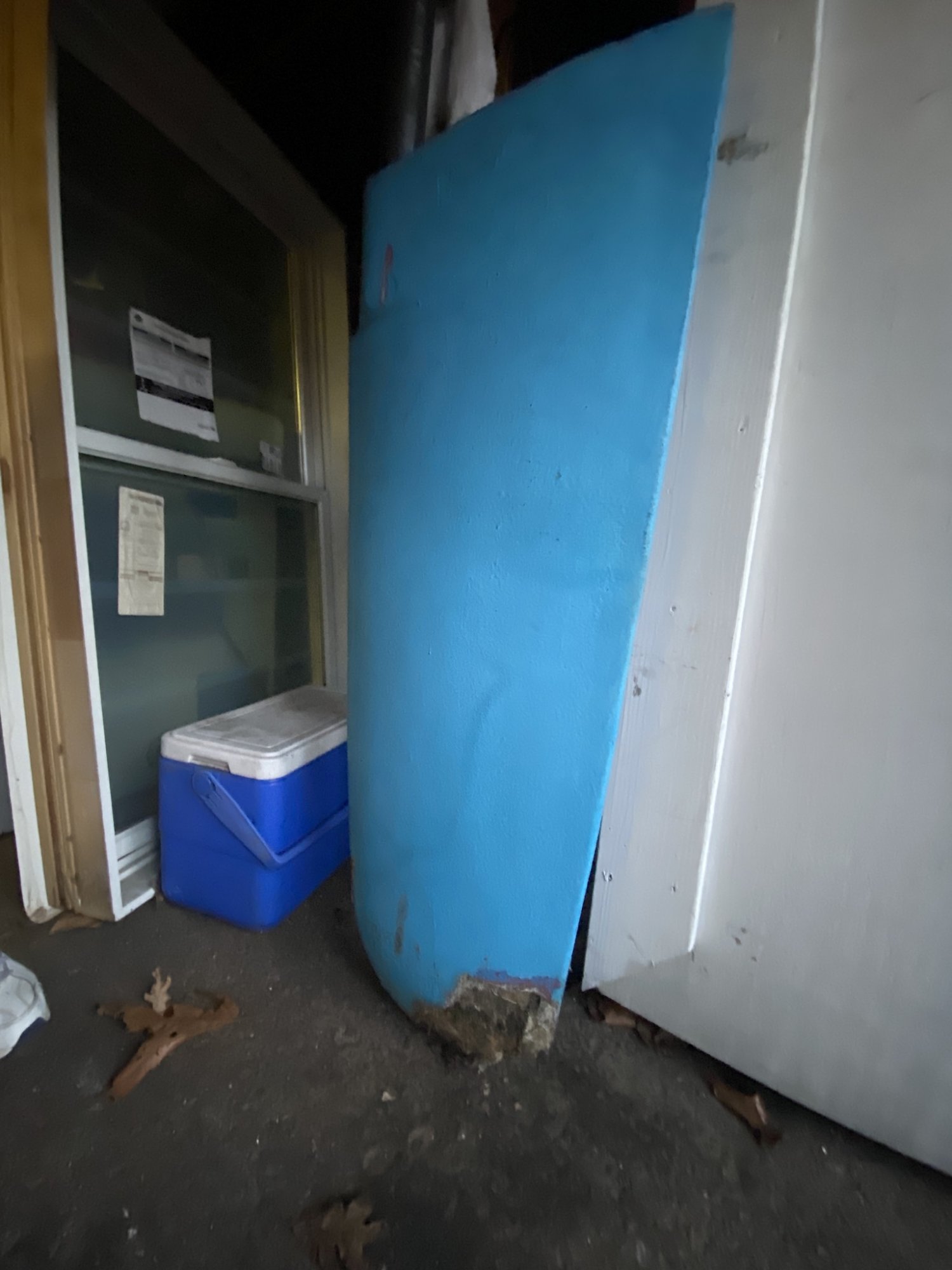

So apparently this Rudder is held in place by just one bolt at the top on the tiller. seems kind of strange that just one bolt would hold the whole Rudder on. Am I missing something? Anybody have any advice or instruction on how to properly install the Rudder to the tiller on a 28 foot o’ day?
