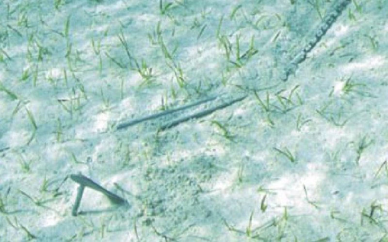

When I mention partially set CQR's this photo is exactly what I'm referring to. This pictured CQR is NOT SET.
Photo From Sail Magazine Anchor Test Report:
