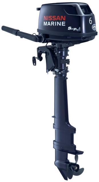

Hello Everyone,
I am thinking about purchasing a 2009 Nissan 6 hp SailPro for my Hunter 22. Are there any pros or cons from people that have this motor?
Thanks
RichH
Feb 14, 2005
4,773
The Nissan 6hp is actually a 're-branded' Tohatsu 6hp ... Tohatsu now making most of the powerheads, etc. for most other manufacturers.
The Tohatsu 4,5,6 Hp (all the same engine just different carburetor jets) is VERY well made and very reliable ... but you need to supply it with fresh/clean fuel or you will have carb problems.
You usually can find a 'better deal' by simply buying a Tohatsu from high volume internet sources (they usually include shipping in the pricing).
