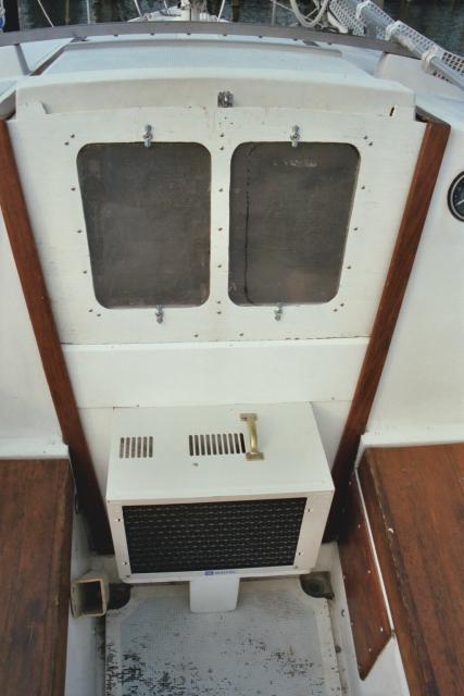

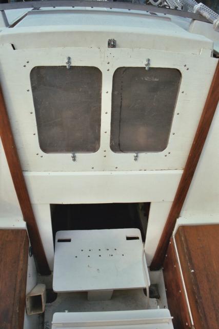

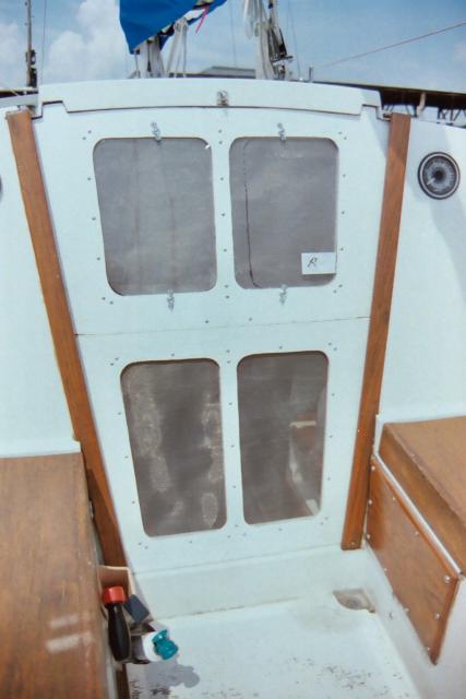

I used a window AC unit...
installed in a drop board replacement framework on my previous 27 footer. I built a set of drop-in screen boards first, and substituted the lower one with the AC mounting panel, closing the upper screened openings with slide-in plastic panels.
The garage door opeining handle on the AC unit was bolted to the frame above the center of balance, making it easy to install and remove. Climbing over it once installed is another story...
