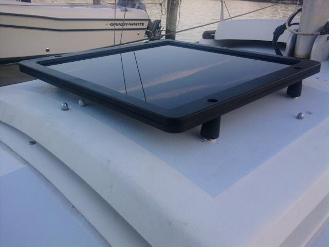

This is what I use to keep the battery charged on my Oday 22. 5W solar panel mounted via 4 snaps on hatch allowing the panel to be removed and stowed when sailing. The "legs" are rubber stoppers allowing some flexibility so the flat panel can be mounted to a curved surface. Stainless screws hold the snaps and the panel to the legs. Bought the panel from newegg.com for $49.00. Same panel at West Marine $79.00
